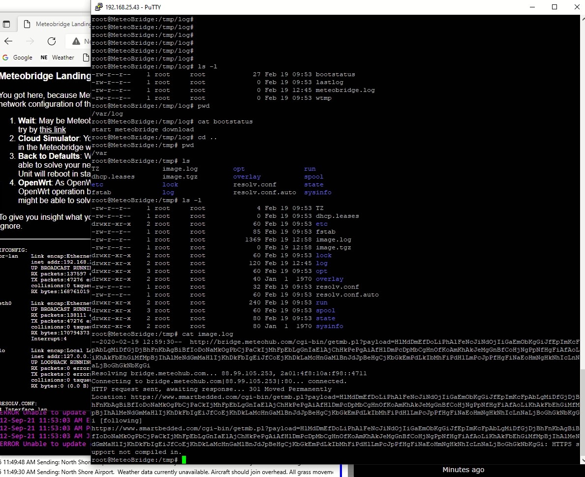

/var/log does not contain a start.log.
There are 3 files of ZERO length - lastlog, meteobridge.log, and wtmp.
And a single file of 27 bytes - bootstatus - which contains the text "start meteobridge download".
I notice that in /var there is an image.log file which ends with a message "HTTPS support not complied in." May be this is of help.
The create date on image.log is consistent with the Date() on the device. i.e. indicating recently created.
See attached.
Rgds Steve
