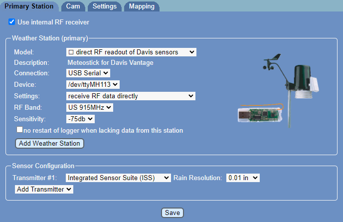

Could you post up a Screen shot of your Station>Primary Station web page?
Re: Is anyone else genuinely unhappy with Meteobridge PRO?
See attached.
- Untitled.png (43.22 KiB) Viewed 3702 times
Signal is very weak for an ISS just 15 feet away, or if the 15 feet the distance to the console?
You might try to set RF threshold to -85 db, which works fine in many cases, unless you have a broad RF noise floor.
I have had MB PRO for repair where the RF plug on the back has got loose and by screwing the antenna to it the whole connector is rotating and by that the internal antenna connection cable winds up and can finally disconnect from the RF board. Is your RF antenna plug having this problem?
