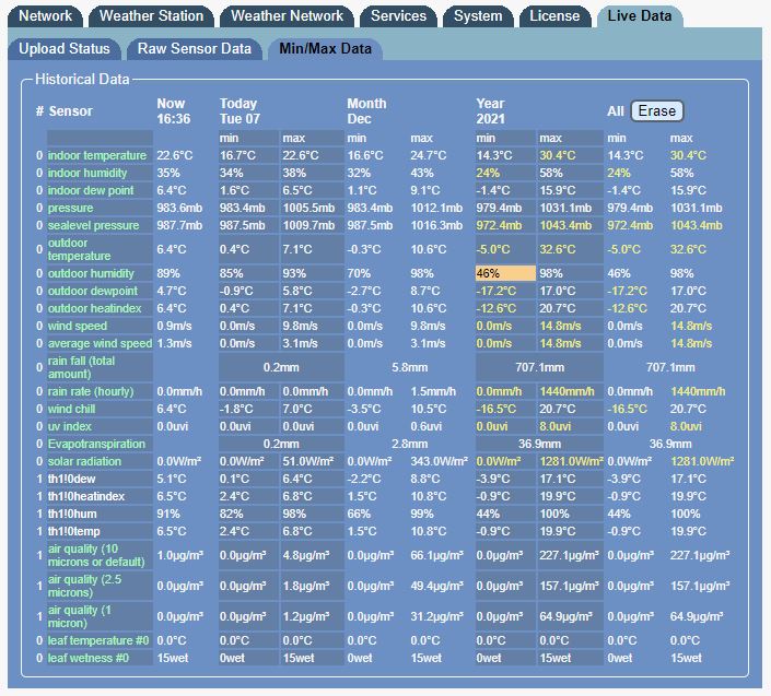

Following a server crash I decided to swap from Weatherdisplay to Meteobridge to push the data colleced on my Davis Weather Station to my website - www.upper-caldecote-weather.co.uk
I've got the basic weather data pushing to my site every 10 seconds, I'm having trouble pushing data from my Davis wet leaf sensor and Davis Airlink, I haven't managed to add the tags in the correct files. I can see the data on the Meteobridge setup page, min/max data is showing correctly so I know I've collected it.
Would anyone be able to offer me some assistance or point me to a help file so I can push this data to my website and show the readings?

- Capture 071221.JPG (114.67 KiB) Viewed 3807 times

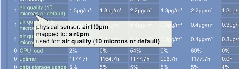

To see the correct sensor name for using to publish the data, hold your mouse above the green text.
It will show the correct sensor-number to use.
Example attached, your sensor will be similar.
The physical sensor number is based on which station the data comes from. air1!0pm
The mapped to can be done by you, yourt MB gives a default mapping => air0pm
There is also a short descriptive text.
The leaf sensors are reported by your Meteobridge as TempHum sensors th??hum and th??temp
Hovering above the green text will display the number to use instead of the ??, standard number is 15 for the first one.
More about the sensor-name usage at https://www.meteobridge.com/wiki/index.php/TemplatesWhen you have a fully equipped Davis Vantage you might also have soil and leaf sensors. These are also reported as temp/hum sensors, but there is no dewpoint data computed for these types of sensors. soil sensors are enumerated as "th10temp", "th10hum", ..., "th13temp", "th13hum" and leaf sensors are listed as "th15temp", "th15hum", ..., "th18temp", "th18hum". "hum" values do not represent relative humidity in that case but data in units "cbar" and "wet". However, Meteobridge does not invent new unit selectors for it, so you have to use "hum" as a generic selector to get "cbar" and wetness data from the soil/leaf sensors.

- air-sens.jpeg (74.38 KiB) Viewed 3796 times

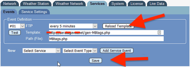

The following are going going missing for the tag dump (http://www.upper-caldecote-weather.co.u ... p?sce=dump)
To add the addtional tags I'm adding them my 10 second upload on the meteobridge event tab, editing the MBtags.php and MBtags-template and uploading, just can't figure out what I'm doing wrong!

Hi Richard,
checked your realtime file uploads, they are correct.
I checked your gen-MBtags.php, which is correct.
There is only one reason for the missing fields in MBtags.php
Did you push the "Reload Template" and "Save" in you Meteobridge setup?
See attached screen shot.
Only if the template is reloaded the added values will appear.

- MB4-services-events1.png (62.94 KiB) Viewed 3638 times

Wim,
You are a star! Thank you, that appears to be the missing link to making it work!!
Thank you so much!!
