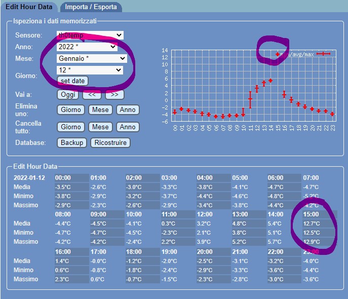

Today I rebooted to install the update and the date went back to January 12, 2022.
Immagine 2022-02-02 141130.jpg (116.24 KiB) Viewed 3963 times
MeteoBorgo: www.meteoborgo.it

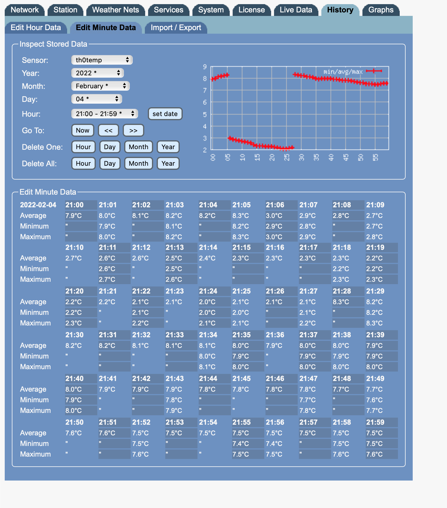

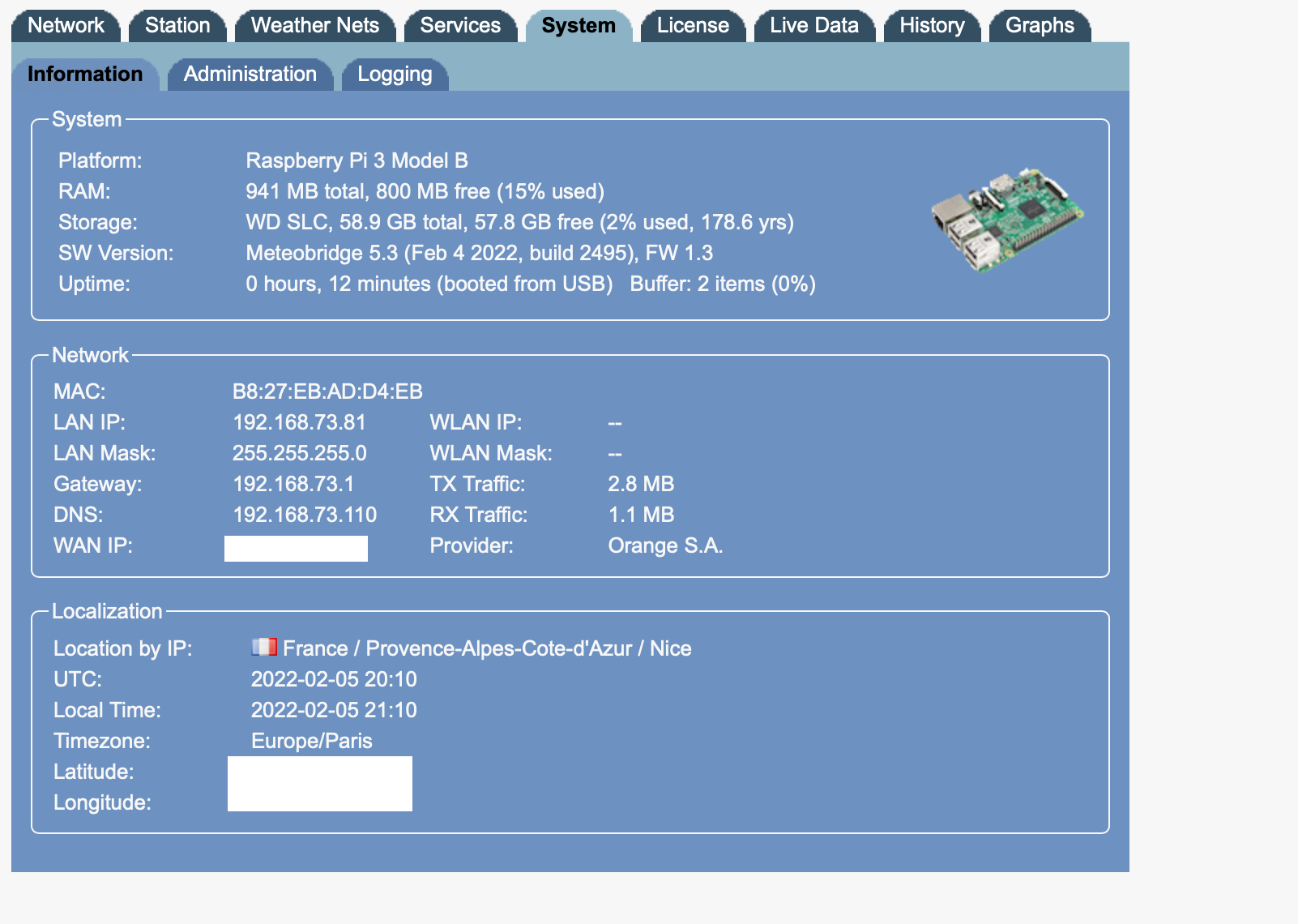

Hi
problem still present
did a reboot this evening for a maintenance
unfortunately the meteobridge reboot at the time of the last reboot (yesterday -24h) and wrote the DB in the past
after a second reboot. prb solved
please, before write the DB, check if the time is accurate
Capture d’écran 2022-02-05 à 21.10.08.png (262.98 KiB) Viewed 3883 times
Capture d’écran 2022-02-05 à 21.09.59.png (449.54 KiB) Viewed 3885 times
Re: wrong system time after reboot
Version 5.3 should have this solved. If not please send credentials for remote login again to "into(at)meteobridge.com".
