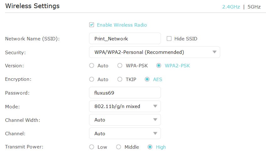

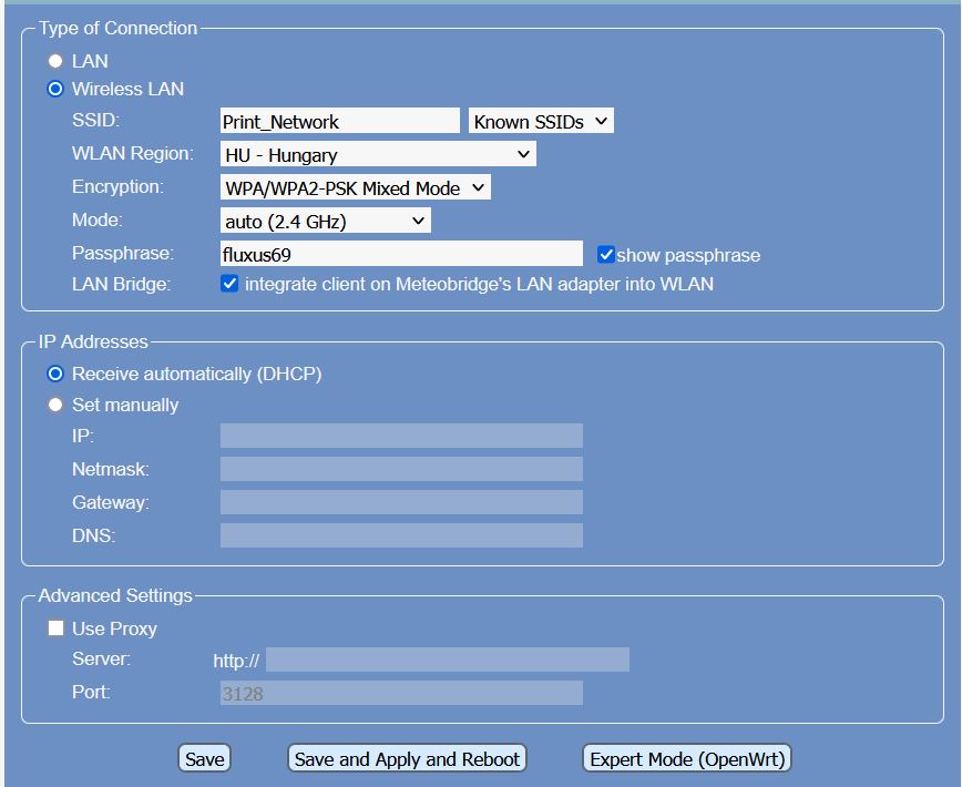

Hello everyone,
I've successfully flashed my new MR3020 (HW version: 3.2) to Meteobridge. However, it is incapable of connecting to my router (TP-Link Archer C1200 V2.0) wirelessly. I tried with static IP and using a USB stick to help it but they led me to no success. It is always stuck at the fast blinking phase plus the Wifi icon doesn't light up.
I attach both the router and the Meteobridge settings to get a clue and might give a hint of what is wrong with it.
Thank you in advance for your help!
Gábor
Gábor
- Router.JPG (41.71 KiB) Viewed 24484 times
- Bridge.JPG (75.29 KiB) Viewed 24484 times
Re: TP-Link TL-MR3020 Version 3 now supported (with WiFi)
Please select "WPA2" mode.
