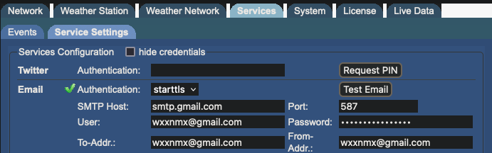

This is what my meteobridge settings for gmail look like.. "password" is a generated App Password as mentioned above.
Screen Shot 2022-06-22 at 11.11.05 AM.png (46.94 KiB) Viewed 2189 times

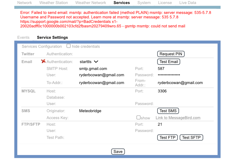

Thanks for that. I've tried the exact equivalent. Response is
"Error: Failed to send email: msmtp: authentication failed (method PLAIN) msmtp: server message: 535-5.7.8 Username and Password not accepted."

Not sure why you're seeing "msmtp" (a Linux thing?) and "method PLAIN" (when it should be "starttls") .. Any way, did you make sure the generated App Password had no spaces in it when you copied it into Meteobridge? It displays on Google w/ spaces to make it easier to read, but the entered password should have no spaces.

Post by rydercowan »
Thanks again. Definitely no spaces in app password. Attached is exactly what I see.
