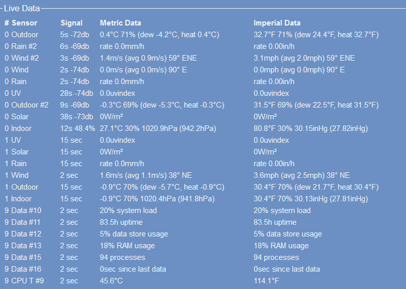

Hmm, there are two times "th" and "thb0", but that are actually different stations. How do i distinguish between them?

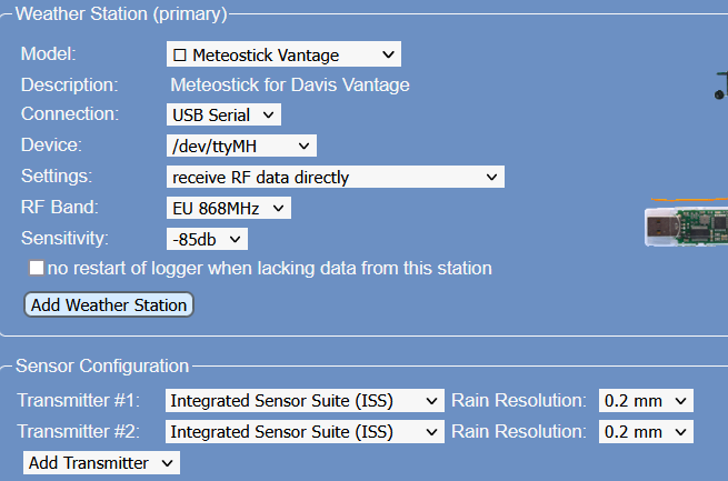

I have two Davis IIS connected to a Meteostick and a tempest weather station.
Line1: Tempest (without pressure?)
Line2: Davis IIS
Line3: Davis IIS
Line4: Tempest Weatherflow
Line5: Meteostick USB (because of temp="27.2")
For my it looks like the automatic sensor naming is doing something bad. Why not just display them as added (or like it was working perfectly with Meteohub)?

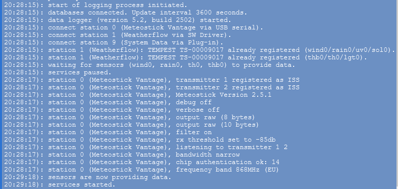

Some logs about stations
Raw Sensor Output - Live Data

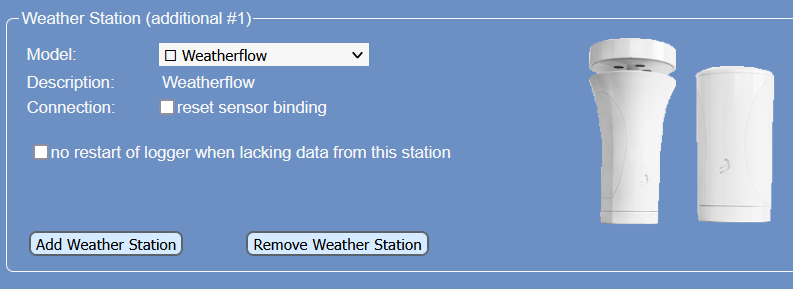

Station1 (Tempest Weatherflow)
Meteostick with two IIS
