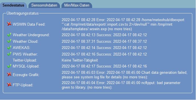

unfortunately my MB suddenly stopped working, database seems to be not available anymore. Pls. see screenshots.
What has happened? Any chance to get the lost data back?

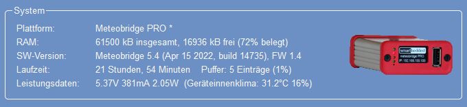

What are the details of the storage device on the Information>System page?

Mattk wrote: Tue Apr 19, 2022 10:50 am That would be a rather large standard consumer grade USB and my guess has seen a lot of read/write and my guess has probably failed?
Sorry I need to correct that as I mistook the RAM value for the Storage details which normally sits between the RAM & SW version lines. The unit is not recognizing the USB storage (at all) which does tend to indicate some sort of storage issue.
You could pull the unit apart and re-seat the USB but I suspect the USB is failed?
Do you know what make/model the USB in this unit is as these details are not showing?

Re: MB suddenly stopped working
@WERTHE: the screen shot in your first posting ist missing the storage line. This indicates that USB storage has not been recognized during boot. Do you still have that symptom?
