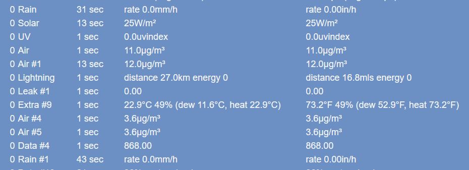

2. you will see lightning in the MB raw data only after at least one strike has been recorded before
3. the same with live data in the WS View Plus app or in the GW2000 WebUI
after the first strike recorded, the GW2000 console retains the timestamp of the last strike recorded and the distance of that strike (as do the GW1100 and WN19x0 consoles; the GW1000/WH2650 don't) - so does Meteobridge and the information can also be retrieved as [lgt0total-lastval] max number of strikes at the day of occurrence, [lgt0dist-lastval] lightning distance of the last strike and [lgt0total-nonzerotime=epoch:] time of the last strike in EPOCH notation (seconds since 1.1.1970).

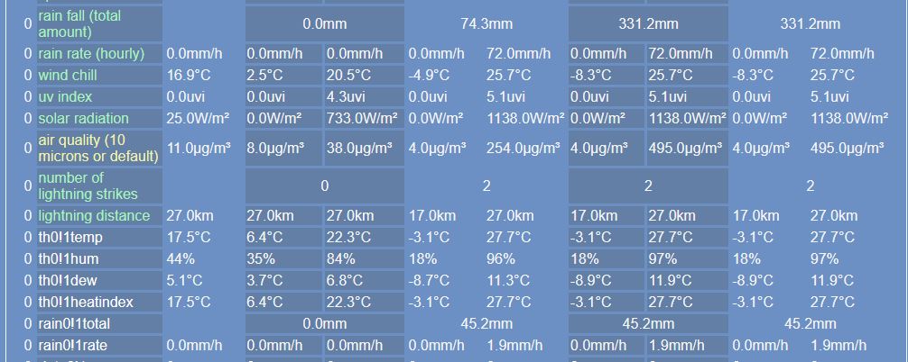

4. for the WS90 you can see in WSView+/GW2000 WebUI Live data the rain data from either the WS90 or/and (!) another traditional outdoor rain gauge (WH40 or WH65/WS69 array). It depends on what is registered to the console (see: SensorsID menu point). If a traditional and the WS90 "piezo" sensor are both connected to the GW2000 (FW 2.1.3 on or GW1000 and WH2650 from firmware 1.6.9 on, GW1100 from FW 2.1.2 on), they will be shown synoptically in the Live Data and on the Ecowitt cloud dashboard (provided you have registered your console there).
5. MB FW 5.4 last release will be able to show both rain sensors in the RAW sensor data and in the Min/Max history.
The traditional rain gauge is shown as Rain or rain0total (primary station), the WS90 "piezo" rain is shown as Rain #1 or rain1total/rain0!1total.
6. The API for the GW1000, GW1100, GW2000, WH2650, WN19x0 consoles and their clones is the same (last firmware needed).
hence this is covered by the GW1000 driver/station in Meteobridge.

- MB-5.4-WS90-WH40-raw.JPG (43.27 KiB) Viewed 3086 times
- MB-5.4-WS90-WH40-min-max.JPG (84.33 KiB) Viewed 3086 times

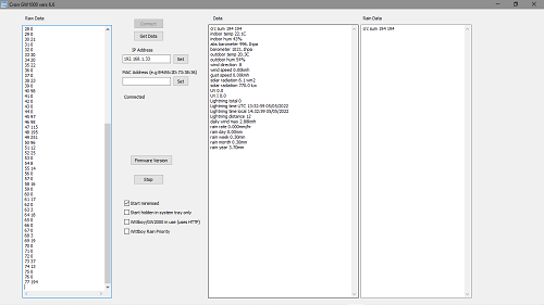

Seriously, it's a download link. It contains the interface program of Weather Display (crongw1000.exe, to be extracted, unzipped), which, when you put in the IP address of your GW1000/GW1100/GW2000/WN191x console, will display the current sensors read from the API. It creates a (repeatedly overwritten) file gw1000.txt in the directory you run it from, which contains the posts of the console(s) in decimal form.
Re: Meteobridge PRO and GW1000
The interface is divided in four parts (left to right):
1. raw data (decimal)
2. configuration
3. sensors data translated
4. rain data if you own a WS90 and even have an additional WH40 connected
rain data from WH65/WS69 or WH40 alone (without a WS90 connected) will appear in part 3

It works thank you.
- Captura de pantalla (150).png (35.24 KiB) Viewed 2943 times
