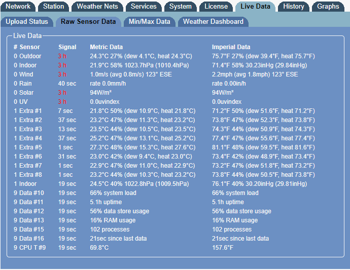

On the following days I noticed strange things happening:
Primary station lost connection to MB, except rain data.
At the same time another RPI was getting information from the GW1000 in question via FOSHKplugin. The situation might recover after some time or change to the another GW1000 going offline.
At the same time, FOSHKplugin was actively and successfully communicating with both GW1000s.
After posting my question at https://www.wxforum.net/index.php?topic=43923.0, I got some hints for further investigation.
It turned out, that MB is having a problem, if I have two GW1000s connected the same time via the "normal" GW1000 connection.
I was testing various combinations of Primary station and station 1: interchanging both as primary station, only one of them as primary or St1.
The same time I added an "Ecowitt uploader" for both stations from FOSHKplugin.
I had no errors when only one GW1000 was connected "directly", but always had a breakdown of on GW1000 if both connected. At the same time, the FOSHKplugin fed stations were running flawlessly.

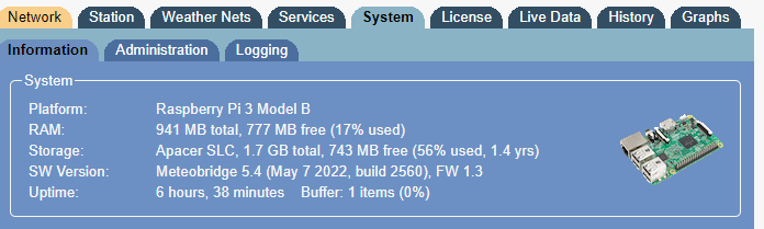

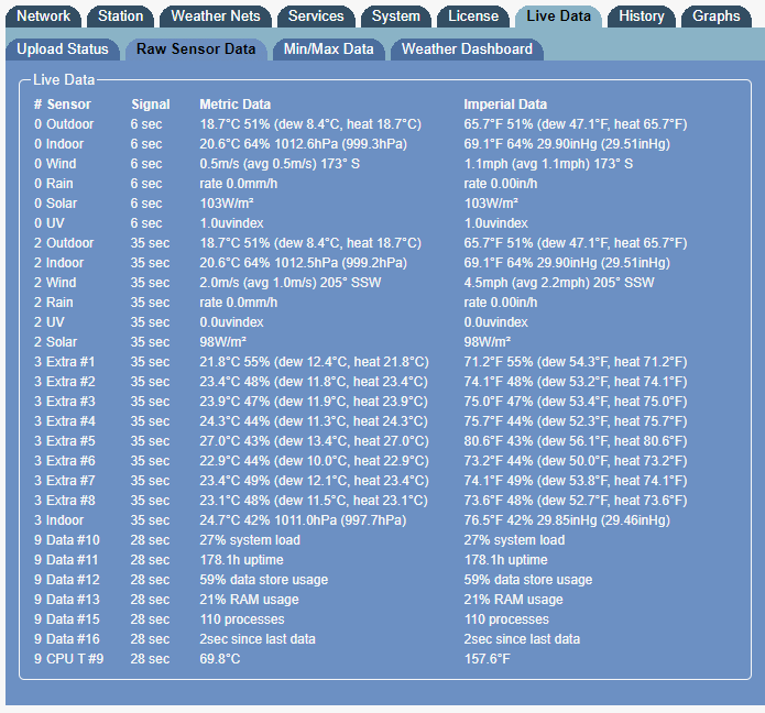

- Temporary solution Primary=St2, St1 disconnected = St3
- mb_temporary_solution.PNG (61.25 KiB) Viewed 2952 times
- Versions
- meteobridge_error_04.PNG (25.15 KiB) Viewed 2952 times

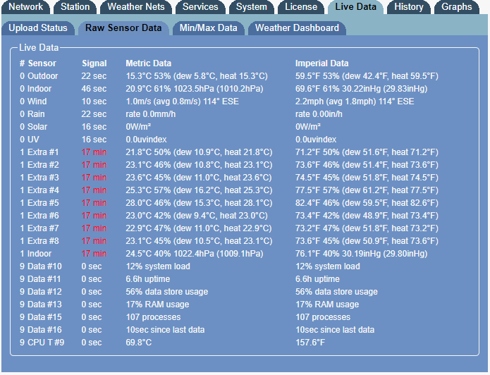

- Station 1 "offline"
- meteobridge_error_03.PNG (54.67 KiB) Viewed 2952 times
