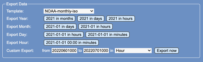

@Eucalyptus: If you are not familiar how to generate exports. I recommend to use the NOAA iso template, like below.
Bildschirmfoto 2022-07-04 um 11.02.32.png (39.15 KiB) Viewed 1042 times
Please generate in resolutions "hour" and "day" and for period "202206010000" to "202207010000" to get full June exported. "Rain" column shows logged and stored rain data. If you compare that to the console values it should match. BTW, you find exported files in SMB share of your Meteobridge, where any windows PC can connect to as a pc-network drive. Or you can call "http://ip-of-your-meteobridge/cgi-bin/download.cgi" where you can grab files from "export" folder as well.
