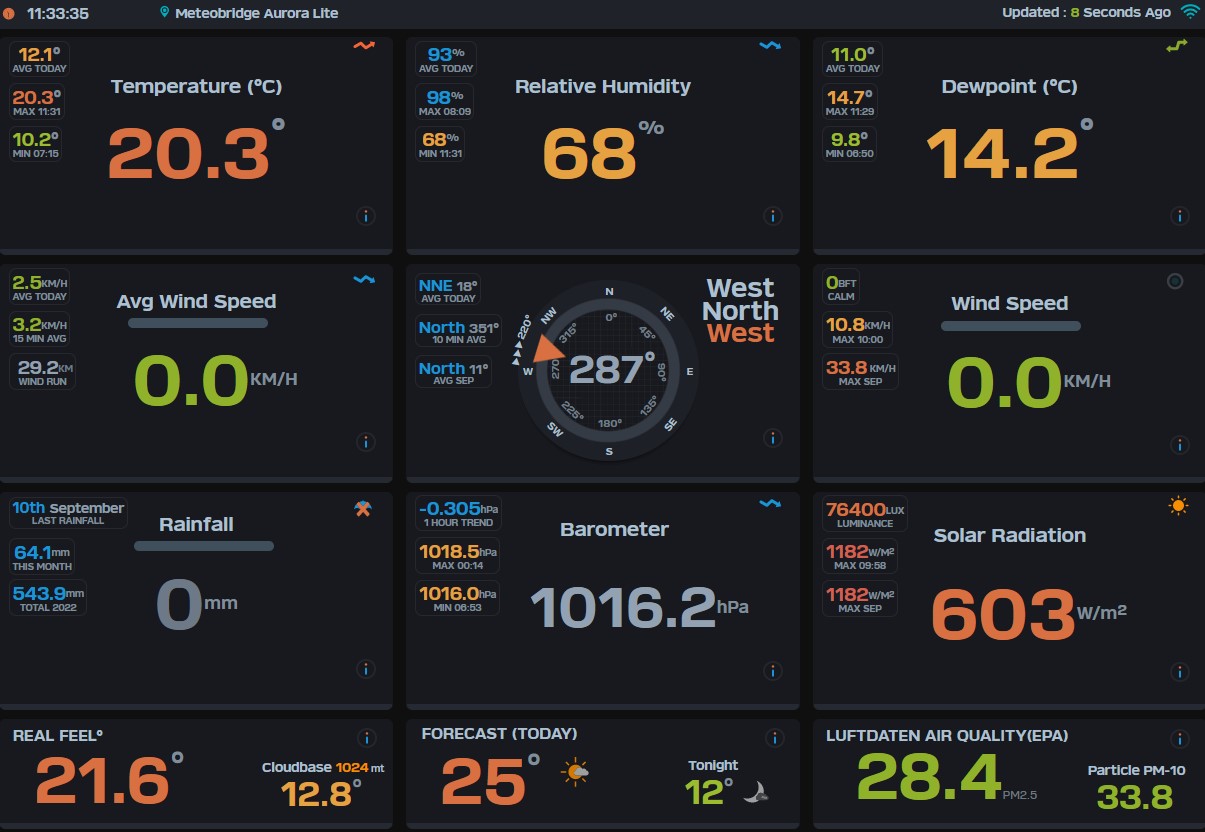

Gyvate
Posts: 458
Re: How to enable Weather Dashboard. **solved**
Post by Gyvate »
with build 2841 the simplfied Aurora dashboard is now working (after completing the setup inside W34-Aurora, e.g. API keys) in parallel to the "old" W34 dashboard which was upgraded from 8.34 to 9.34.
With the download of 2841 also some php (index.php) and data files of the "old" W34 dashboard were modified, deleted, overwritten.
Luckily I had a backup 8).
Gyvate
Posts: 458
Post by Gyvate »
there is also a version with a white background - click on the lamp / sun icon ...
