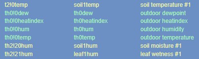

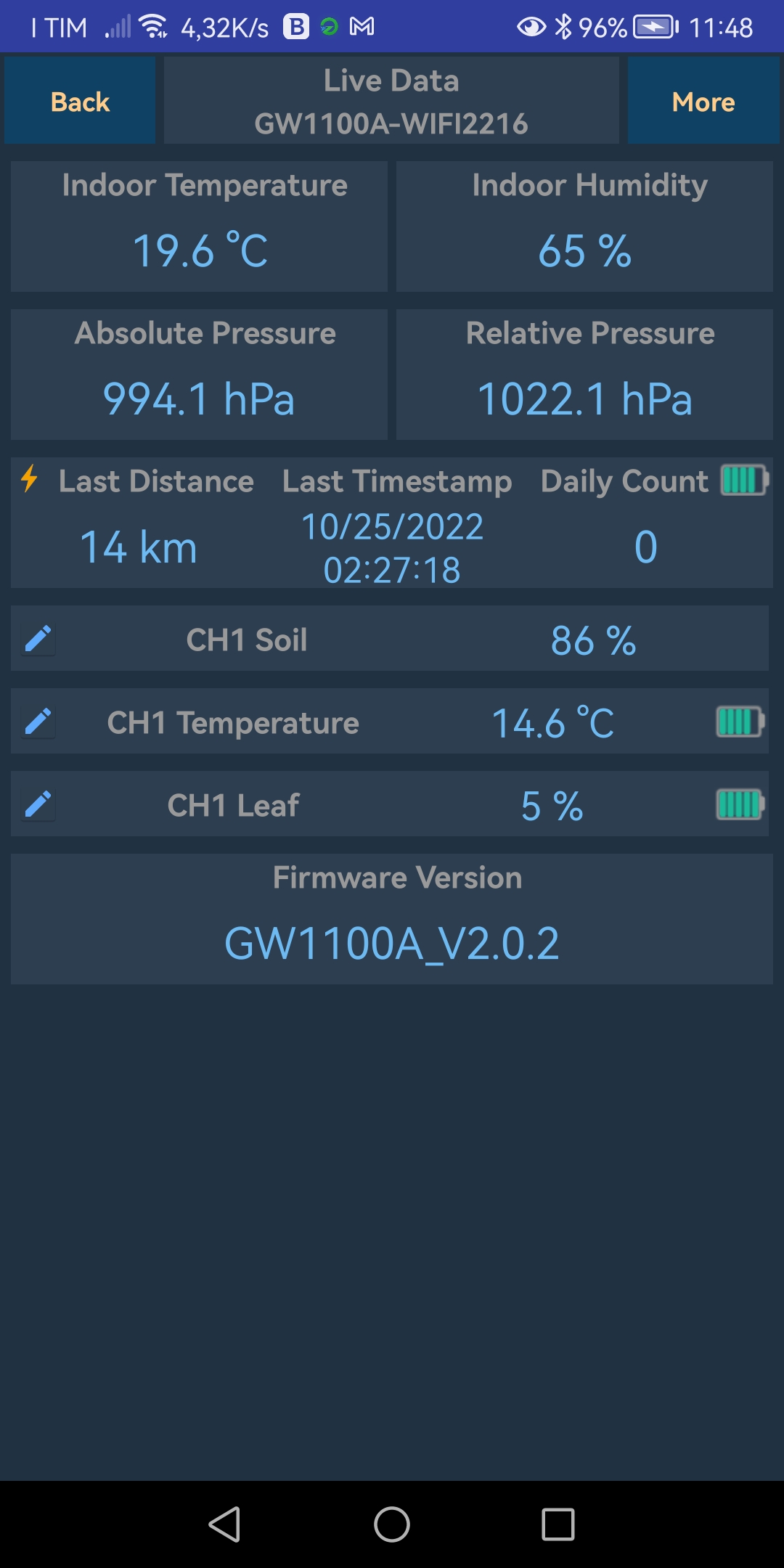

hello,
MB nano, GW1100 set as station#2
soil moisture and soil temp works fine but I can not see the raw sensor data of the leaf wetness (connecet to channel#1)
tried all combinations also on other channels but without success
what is wrong?
mant thanks in advance for any comments

The actual WN35 CH1 reading is 4% visible in the console, WS View Plus and the ecowitt.net dashboard.

yep
- it appears now as Outdoor #40 in the live raw data list - and as thx!40hum in the min/max list (x=0, 1, 2: station number)
