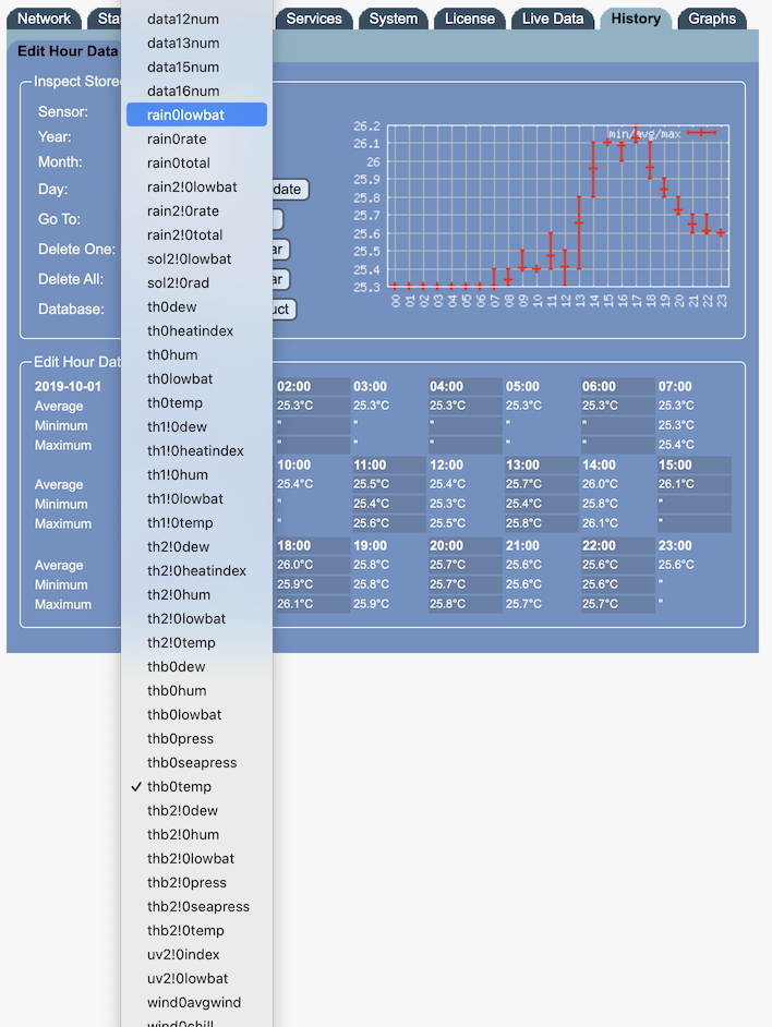

I am not 100% sure as I do not use any charts from my meteobridges.
But for your meteobridge an Airlink is another complete "weather"-station.
It has multiple PM and temp hum sensors.
The Airlink sensors will be in the same sensor lists as all the VUE sensors.
The Airlink sensor-values are stored in the meteobridge exactly the same as the VUE sensors.
Attached the sensor list of a Nano in a Davis Vue and sensors from other devices added.

Metacharts can take any sensor from any connected weather station. No limits there.
