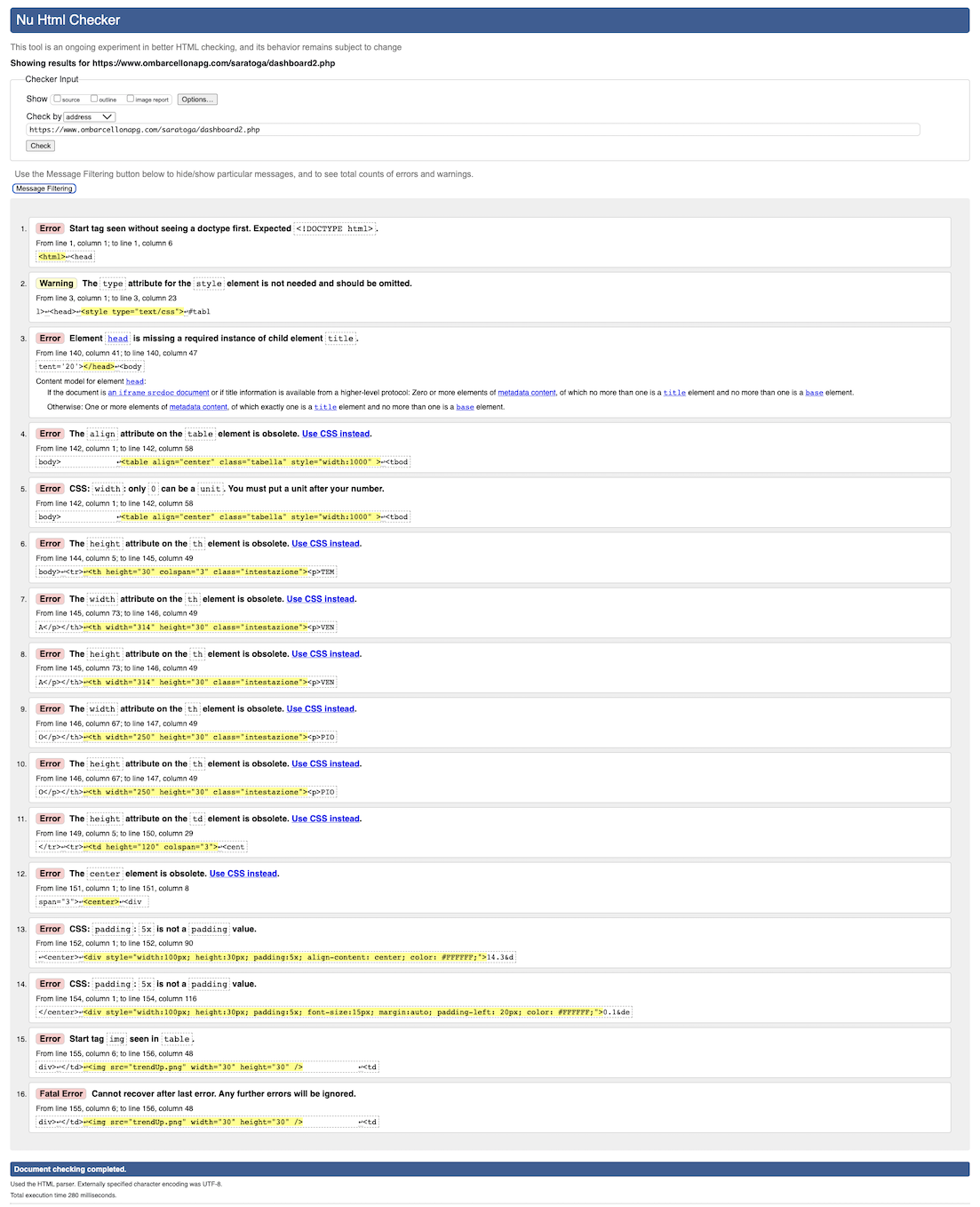

Re: PHP Enter the name of the winds according to the tag [wind0dir-act=endir:--]
HTML problem: The img is not inside the <td> . . . </td>
The browser does not know what you want. It just skipped the <img. part.
Although web-browsers are very forgiving, they can not solve every language error.
When you validate your HTML the validator stops also at the <img>
https://validator.w3.org/nu/?doc=https: ... board2.php
Solutions:
1. Go step by step and and test between each step
2. Use a validator to check your html => https://validator.w3.org/
3. HTML is a language and as every new language you have to learn the basics
== Buy a book such as "HTML and CSS for Dummies" if it is available in Italian or
== HTML CSS: La guida completa al web design per progettare e sviluppare siti web in 7 giorni Copertina flessibile – 15 giugno
== Use the website https://html.com/
4. always test with different browsers, at least Chrome and FF.
If you want to build your own websites, you have to understand and use two new languages, HTML and PHP.
That takes time but it is a very interesting and rewarding hobby.
If you just want a small html/php page , find a IT-student who will be happy to do it for you for a small fee.
Succes, Wim
