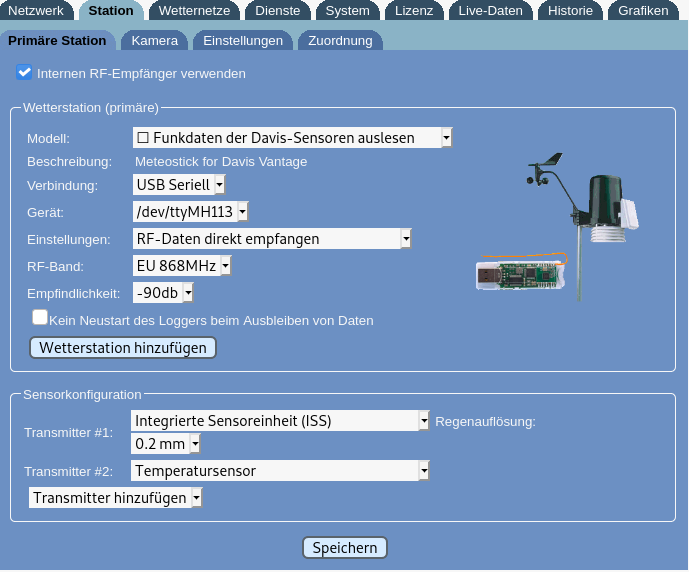

but not this page, older picture e.g
The question is why not? Why is this page (and according to your explanations in AP mode the router connection or DNS resolution doesn't play a role) not accessible. And how do I change that?
