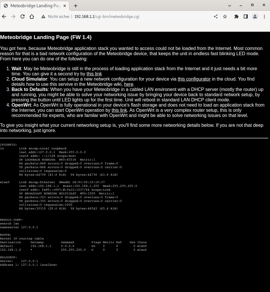

Ok, I select Reboot WIFI AP>Display shows Reboot Wifi Access Point>AP but does not start.
I do a cold start>MB starts as AP>IP address 192.168.1.1>I start Chromium Web Browser when I enter the IP of the AP I get here and no further
Bildschirmfoto vom 2023-09-03 22-26-05.png (204.5 KiB) Viewed 5061 times
The same thing happens when you select LAN CLIENT
Re: Landing Page
OK, when you can reach the landing page this tells that Meteobridge booted fine, and is connected to your LAN/WLAN.
When red LED is stuck in fast blinking mode it tells that Meteobridge cannot reach the Internet. That means your router is not giving the Meteobridge a proper DNS resolution or it is blocking HTTP traffic to it.
Did you just power cycle the Router or did you change something on the router side in terms of hardware or configuration?
