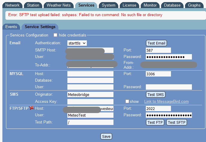

I just bought a meteobridge PRO2 and am trying to upload to an SFTP server.
However, the test-SFTP fails with the following error:
"Error: SFTP test upload failed: sshpass: Failed to run command: No such file or directory"

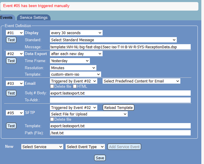

The event itself is configured as follows:
Software version is Meteobridge 5.7 (Aug 11 2023, build 4133), FW 1.3 on a PRO2

Re: PRO2 sshpass error of SFTP upload
Sorry, SFTP was missing on MB PRO2 distribution. Thanks for spotting this.
Just released update should do fine now.

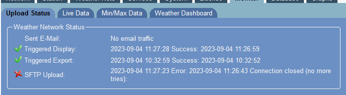

I have installed: Meteobridge 5.7 (Sep 3 2023, build 4145), FW 1.3
The "test upload" now works, and the testfile is created on the server. I also see the login in the server logs.
The upload from normal data however still does not work.
If i trigger it manually it gives the following output:
I've tried different export files and different destination paths.
I see no login attempt in the server logs.
So there still might be an issue in the firmware?
Is there any logging I can provide from the terminal/SSH?

Yes, you are right. I overlooked a code portion that also needs to be updated. It should be fine with just released update.

Re: PRO2 sshpass error of SFTP upload. **solved**
Post by cohenwb »
Seems to be working now. Thanks
