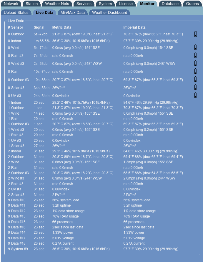

Checked with my setup and data coming in fine via RF (station 0), WLL (station 2), and the new Weatherlibk Cloud API (station2). I have a vue ISS on transmitter ID #1 and a PRO2 PLUS ISS on transmitter ID #3.
logger (02.10.2023 10:47:47): data logger (version 5.4, build 4236) started.
logger (02.10.2023 10:47:49): connect station 0 (Meteostick Vantage via serial).
logger (02.10.2023 10:47:49): connect station 1 (Davis WLL via SW Driver).
logger (02.10.2023 10:47:49): connect station 2 (Davis WL-Cloud via SW Driver).
logger (02.10.2023 10:47:49): connect station 9 (System Data via Plug-in).
logger (02.10.2023 10:47:51): waiting for sensors (wind0, rain0, th0, thb0) to provide data.
logger (02.10.2023 10:47:51): services paused.
logger (02.10.2023 10:47:58): station 0 (Meteostick Vantage), transmitter 1 registered as ISS
logger (02.10.2023 10:47:58): station 0 (Meteostick Vantage), transmitter 3 registered as ISS
logger (02.10.2023 10:47:58): station 0 (Meteostick Vantage), debug off
logger (02.10.2023 10:47:58): station 0 (Meteostick Vantage), verbose off
logger (02.10.2023 10:47:58): station 0 (Meteostick Vantage), output raw (8 bytes)
logger (02.10.2023 10:47:58): station 0 (Meteostick Vantage), output raw (10 bytes)
logger (02.10.2023 10:47:58): station 0 (Meteostick Vantage), filter on
logger (02.10.2023 10:47:58): station 0 (Meteostick Vantage), rx threshold set to -90db
logger (02.10.2023 10:47:58): station 0 (Meteostick Vantage), listening to tx 1 3
logger (02.10.2023 10:47:58): station 0 (Meteostick Vantage), bandwidth narrow
logger (02.10.2023 10:47:58): station 0 (Meteostick Vantage), frequency band 868MHz (EU)
logger (02.10.2023 10:48:45): sensors are now providing data.
logger (02.10.2023 10:48:45): services started.
