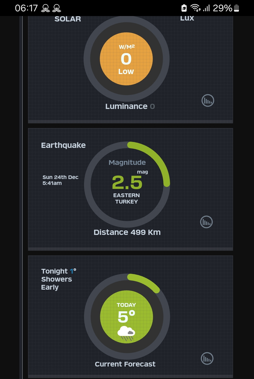

Hi, Brian! I found such a thing: in the mobile and browser versions, there is a narrow strip on the left in Microsoft EDGE. I know you have a MAC. Please take a look.
- 2023-12-24 06-17-25.JPG (235.83 KiB) Viewed 397840 times

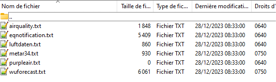

- Capture d'écran 2023-12-27 124342.png (73.6 KiB) Viewed 397757 times

hello Brian thank you for your feedbackweatherist34 wrote: Thu Dec 28, 2023 8:51 am Purple Air data comes from the Purple Air API from their site/hosting.. double check the API key for no hidden blank spaces on the end(often occurs when cut and paste long data because their blank whitespaces their not visible ..), double check the sensor ID number .. look for the file purpleair.txt (check permission on file is writable) in the jsondata folder that is where the data stored on your server.
http://valdefench57sgz.franceserv.com/p ... pleair.txt is blank currently
the ID of the sensor is correct the key supplied at the beginning of 2023 registered (correctly ?) in the original format type
"43Bxxxxx-9Bxx-11xx-B6xx-4201xxxxxx07"
so spaced !
for the file I also didn't modify anything but i just noticed that the Json is indeed "empty"
Have a good day
- Capture d'écran 2023-12-28 092343.png (11.61 KiB) Viewed 397704 times
- Capture d'écran 2023-12-28 092302.png (16.37 KiB) Viewed 397704 times

i have used the ID 47165 and run the stationcron.php . can only say delete the purpleair.txt file and run the stationcron.php manually through your browser your-domain/pws/mbdbfiles/stationcron.php.
double check that API key also ..
i do not have a paid subscription i use the original API key from years ago..
it returned valid data as shown below timestamp converted GMT: Thursday, 28 December 2023 11:10:06
