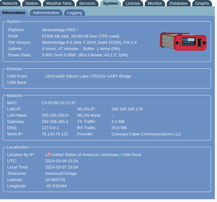

Re: "cannot create table... database or disk is full"
Please share complete "System - Information" tab.

Post by Scareduck »
Screenshot from 2024-03-07 19-04-27.png (100.23 KiB) Viewed 1794 times

Can you please provide me a login? please send URL and temporary password to "info(at)meteobridge.com".
As the ATP storage is not mentioned in the upper section of the "System - Information" tab, I fear that something went wrong with the internal USB storage.
