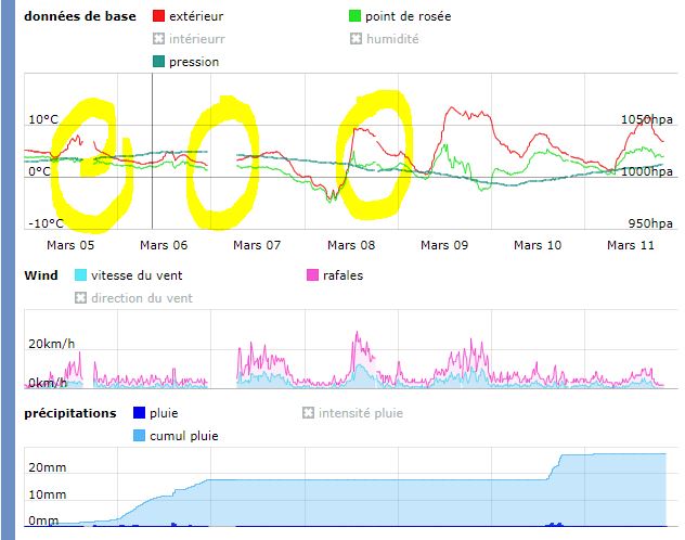

I've been having a problem with my meteobridge pro for a week now.
Every 2 days or so, I have to restart it to get it to accept data from my Vantage Pro2 station. If I don't do this, nothing registers.
Then, after the restart, everything works fine. The data is received and sent to the weather networks.
This problem is very annoying, because if I'm not at home or if I'm asleep, I lose a lot of data.

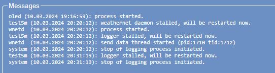

This time, I had the reflex to read the error message.
Here's a screenshot of the error displayed in the log file.
Thank you for your help

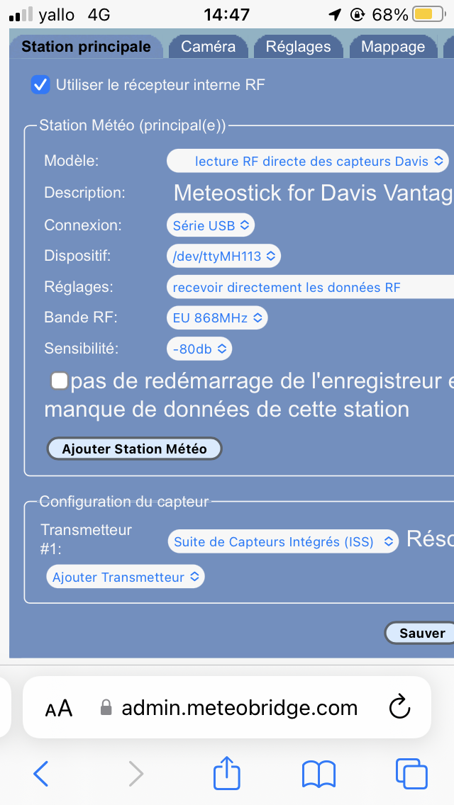

Looks like a problem wit the RF threshold to me. What is your threshold setting and how strong do signals come in?
oncletom17
- Junior Boarder
- Posts: 25
- Joined: Mon Mar 11, 2024 9:38 pm
Re: PROBLEM - Forced to reboot my Meteobridge Pro every 2 days
Here are the values
- A6AE1559-9CB2-4E0E-9864-6815D17DCF1E.png (283.77 KiB) Viewed 2446 times
- DC55430B-5FE6-4E70-AA4D-FD251302E2C4.png (346.95 KiB) Viewed 2446 times
RF reception rate looks ok (92,3%) to me. Can you please give me a remote access for further observation?
