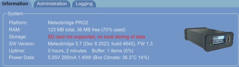

I see disk I/O errors in the logging tab and see the message in the information tab ( SD CARD NOT SUPPORTED, NO LOCAL STORING OF DATA ) after reboot to attempt to correct.
Reboot does not correct. Power cycle corrects for a few days. Note: The power off button does nothing. I assume the SD card is failing?
Screenshot at 2024-03-22 16-02-59.png (61.79 KiB) Viewed 2162 times

Rare one? Have you tried rolling back to previous version in case latest update lost it?

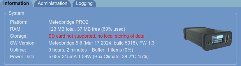

No luck, This time hung, no access. Screen shot after reboot. 2nd reboot its back up again.
Screenshot at 2024-03-23 18-39-48.png (61.36 KiB) Viewed 2144 times

Re: PRO2 SD CARD ** One for Boris **
Can you please give me remote login as explained in the FAQ? Please send credentials to „info(at)meteobridge.com“. I need URL and password.

After reinstalling version 5.8 from version 5.7 the problem with SD card not supported has not reoccurred. The display shifting and going upside down also has not occurred again so far. I will post again with an update in a few days either way.

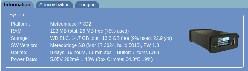

Update: After 8 days the MBPRO2 has been working fine. For some reason the down grade to 5.7 and then the upgrade back to 5.8 has resolved the SD card issue.
Screenshot at 2024-04-01 10-52-48.png (66.24 KiB) Viewed 2035 times
