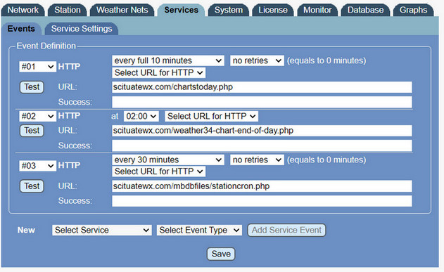

Thank you Torsten. I set to "no retries" but no change. And I see what you mean now about the frequency of the uploads for the daily Charts. Instead of every full 10 minutes, my charts are updating every 60-70 minutes. Do you have any other advice on what to do next? I think I'll begin by reaching out to my Web Host, Hostgator, and ask them if everything is OK on their end. Thanks again for your help!

Does anyone have any ideas why my daily charts are updating every 60-70 minutes, and not every full 10 minutes per the Meteobridge Event Definition?

I still think that your web host is responsible for this.
There may also be some setting in your web space, but I don't know much about that.
Try a different provider.

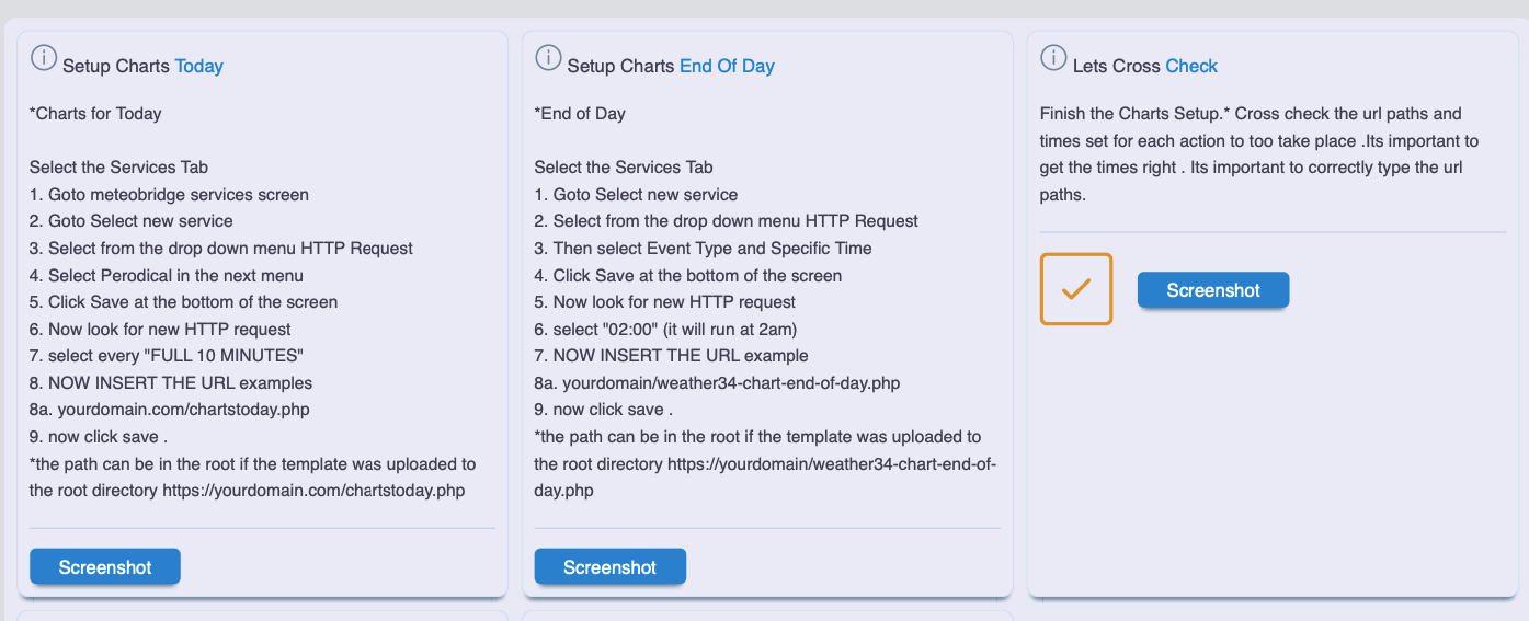

hi good evening a quick look shows you're not running the charts cron via meteobridge see your display now . i simply kick the charts for today twice hence 2 bars are display.
1. you need to setup the services for current day using yourdomain/chartstoday.php
2. you need to setup the services for end of day using yourdomain/weather34-chart-end-of-day.php

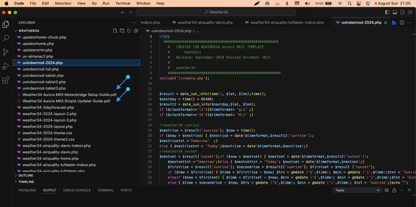

https://www.mediafire.com/file/fpcf73z9 ... e.zip/file setup guide
screenshot of the pdf setup for charts but this in the download link above .
Screenshot at Aug 04 20-57-23.png (166.77 KiB) Viewed 4570 times
have a good read of the setup guide
you can also find the setup guides in the master down
brian ..

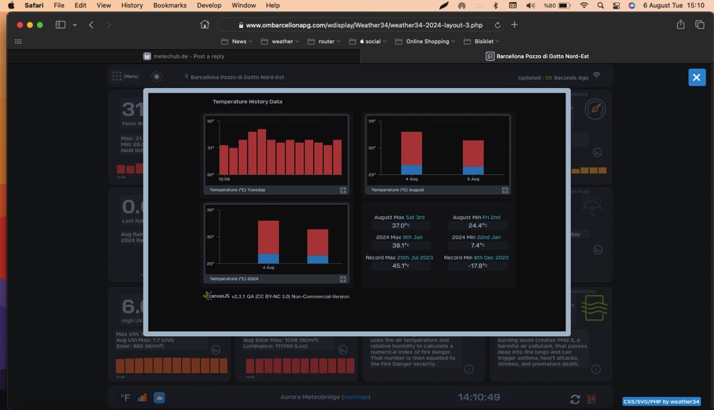

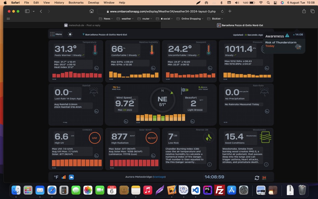

I corrected the address of the individual graph files, which were wrong, and also the stationcron address, perhaps it takes more time and more data than several days. But in layout 9 you can't see the graphs below, is this normal?
Posts: 1841
Re: Weather34 Template - Daily charts
Cavaliere wrote: Tue Aug 06, 2024 9:54 am Hi Brian,
hi good afternoon it looks like you have it running ok i can see the chart data in theme 9 ..
screenshots of your url...brian
