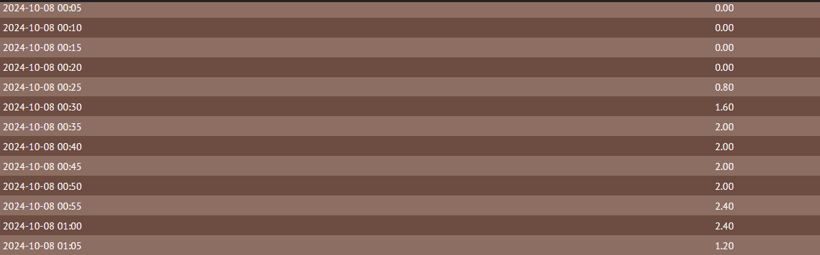

Here are the data stored in my personal website.
this seems to show that rainfall of more than 1.2 mm was recorded before 01:00

here is an export of my Weathercloud data

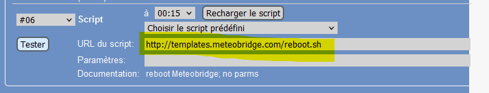

Do you think that using the ‘reboot’ script can have an influence on this problem?
I activated it every day at 00:15 during my holidays, so that in the event of a bug, the meteobridge could restart on its own (see the case in March: viewtopic.php?t=17829)
now I've deactivated it

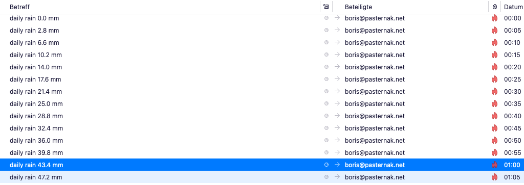

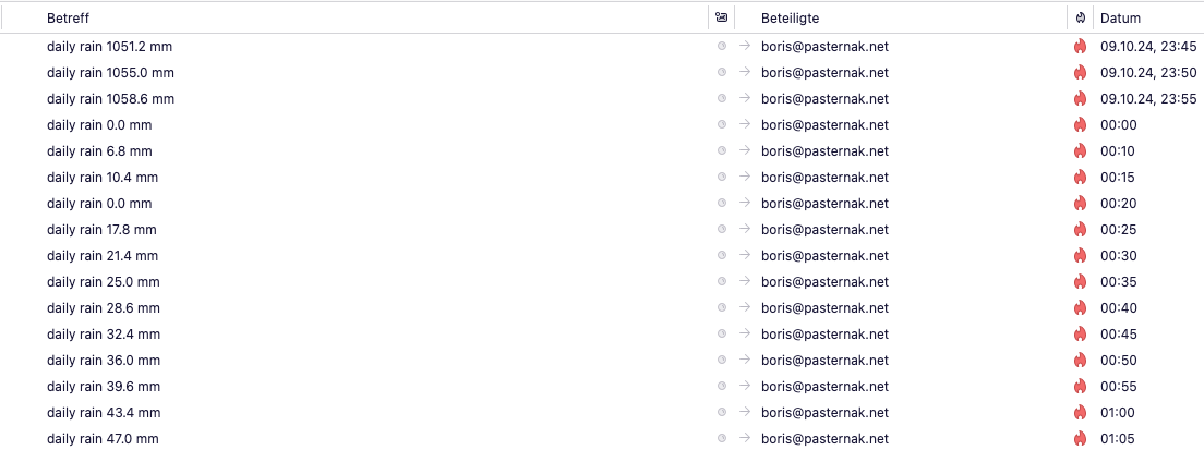

I tried with some simulated rain on my Meteobridge PRO2 and let it email "rain0total-daysum" every 5 mins. Unfortunately, it did not show inconsistencies for first hour of the day as you experienced.
Bildschirmfoto 2024-10-09 um 10.15.01.png (77.35 KiB) Viewed 4947 times
Back to my question, do you have per-minute data storing activated?

I now added the 00:15 backup to my MB PRO2, too. we 'll see tomorrow if that provokes the error you experienced.
Posts: 8033
Re: Problem with rain total.
There is a temporarily "0" while backup is running, but no false increased reporting between 0:00 and 1:00
Bildschirmfoto 2024-10-10 um 07.01.26.png (91.83 KiB) Viewed 4878 times
As long as I cannot reproduce that, I am a bit out of clue...

You mention a "backup". Is it the same as the script I used (reboot.sh)?
Posts: 8033
Ooops, my fault. Next night it will try reboot. :-)

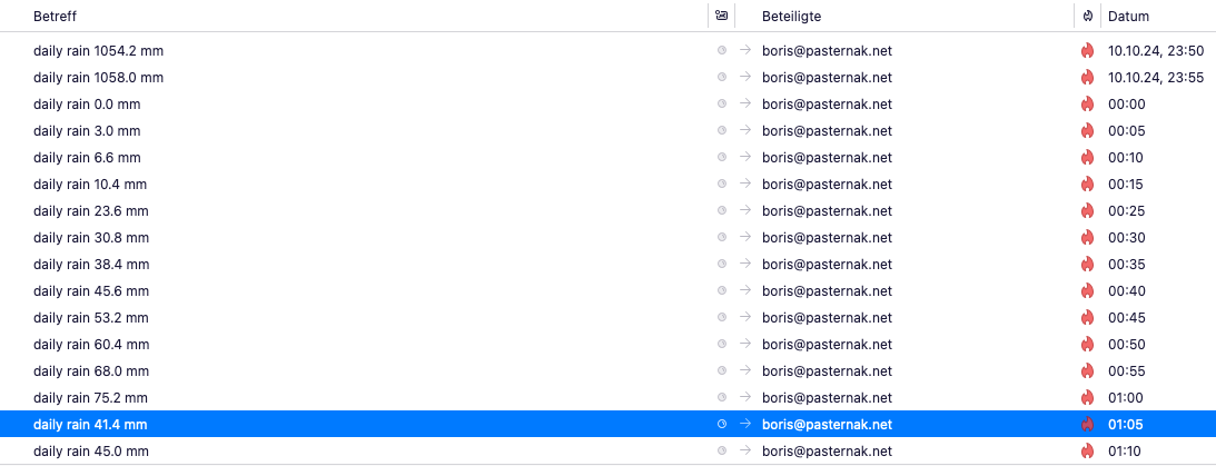

Posts: 8033
The reboot did it to make the issue reproducible.
Bildschirmfoto 2024-10-11 um 01.11.09.png (90.15 KiB) Viewed 4826 times
Now I "just" have to understand why ;-)

on my side, deactivating the script reboot.sh worked!
The proof is in last night's data (no more jump at 01:00)
Posts: 8033
Just released update should have this solved.

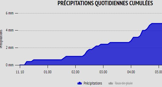

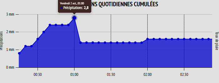

Hello, after 2 years working great, I got the same problem
Capture d'écran 2026-10-02 163549.png (17.17 KiB) Viewed 75 times
At 01:00 AM, Meteobridge divides by 2 the rain fallen between 00:00 and 01:00.
I am still running the version 6.0. Do you think the update to 6.4 will solve it?
