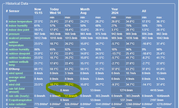

Hello.
After today's update I have a problem with rain.
Today 4.2mm precipitated but only 0.4mm is shown.
Raspberry Pi 3 Model B+
Meteobridge 6.0 (Aug 14 2024, build 3285), FW 1.3
Sorry for my English.

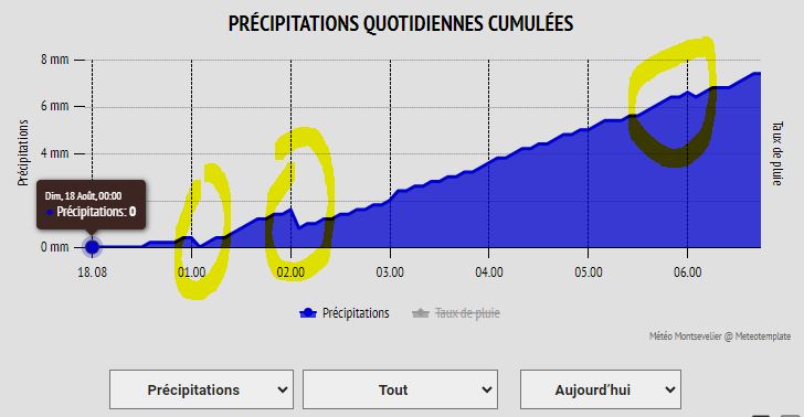

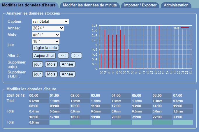

Hi, it seems I get the same problem.
I thought that was because of my website meteotemplate. It seems to happen when full hours pass
An example on my website this morning :
graph_meteobridge_morning

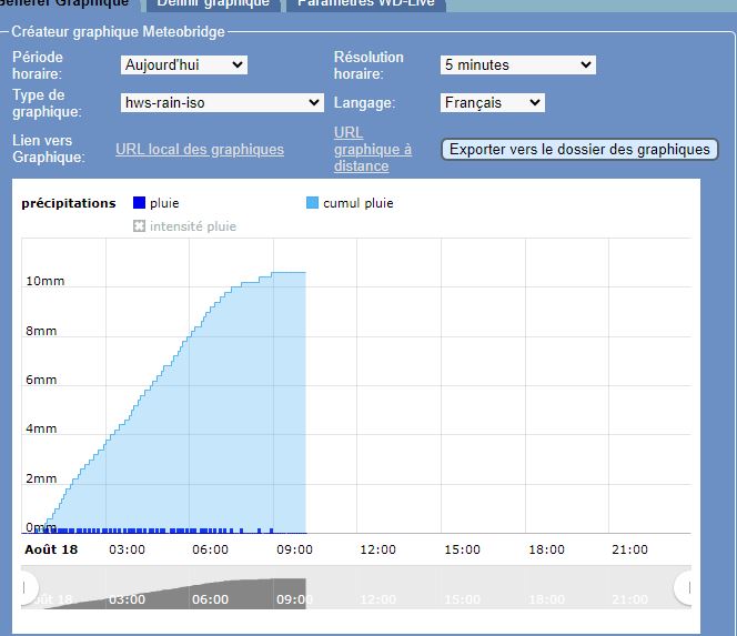

The graph on meteobridge was OK;

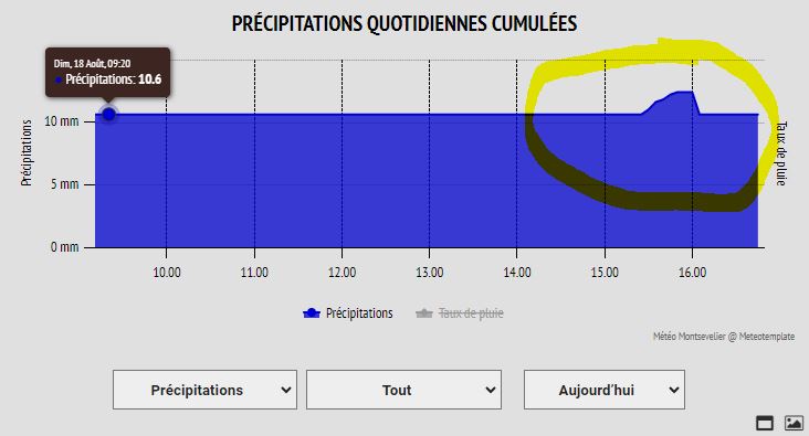

meteotemplate
meteotemplate

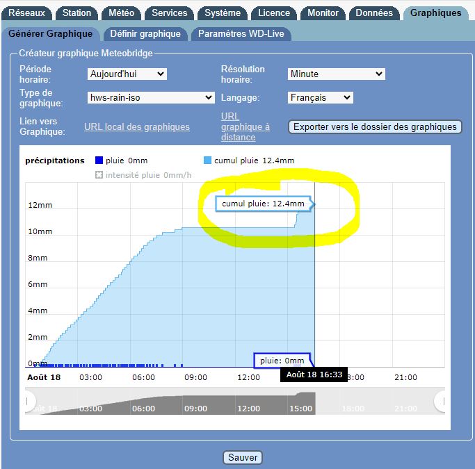

But I've just noticed that this problem is due to my meteobridge.
meteobridge_rain:total

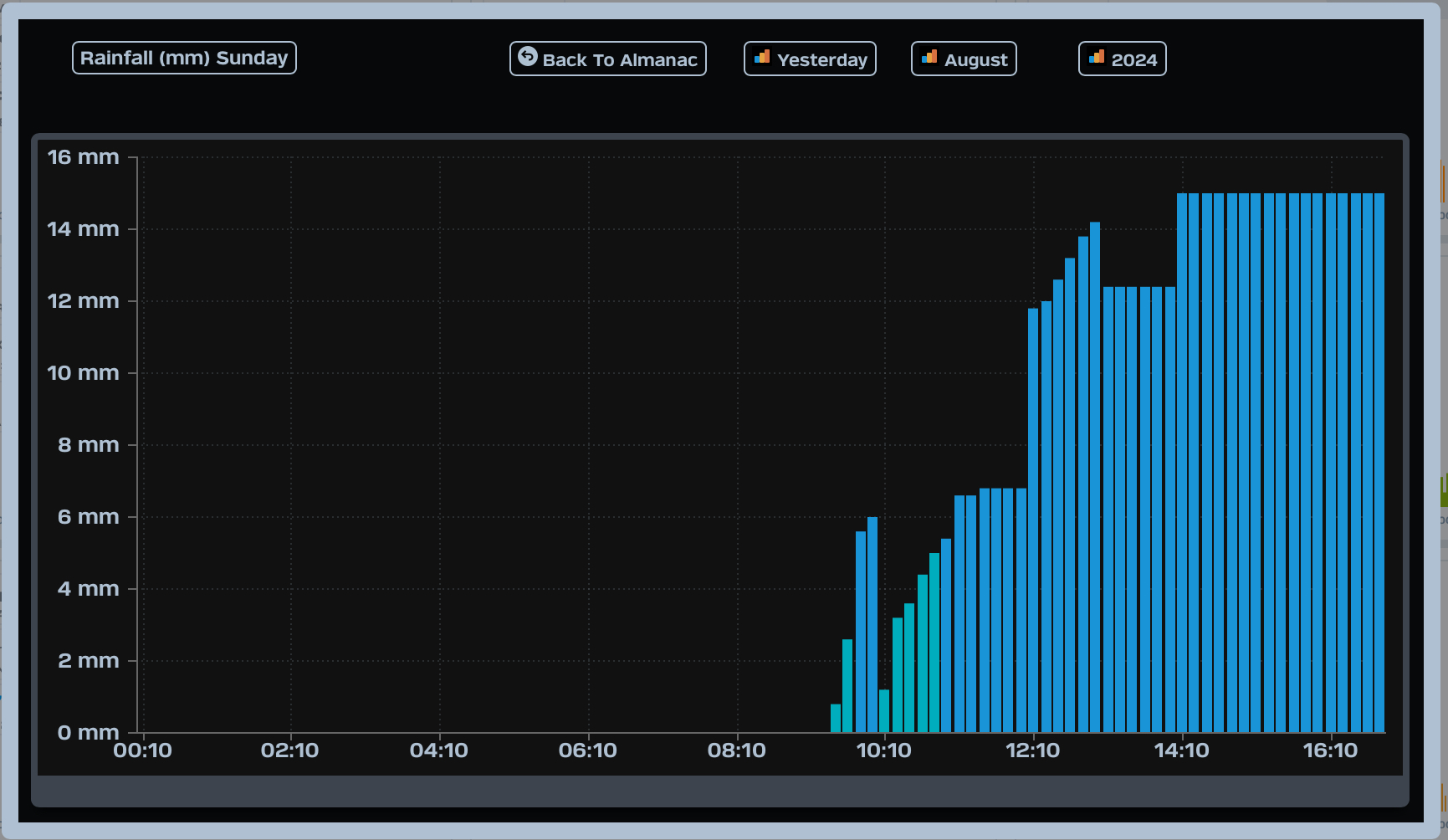

The graph is OK:
graph_meteobridge_afternoon

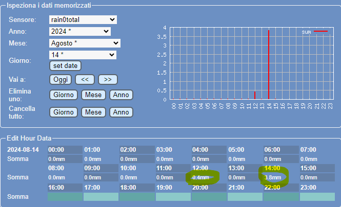

Here the hour data (sum = 12.4)
hour_data
hour_data

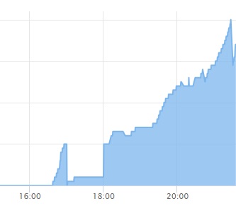

I can see on my website that the problem happened at 16h00
meteotemplate_afternoon

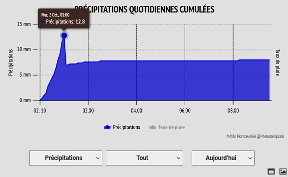

It seems there is still problems with the rain total calculation.
everything is consistent on meteobridge but my personal website recorded additional rainfall, jumping back at 01:00 am. is it possible that meteobridge deleted rainfall to solve the above problem, which was resolved in August?
It seems strange to me that meteotemplate has invented these additional precipitations...
Could you check please?

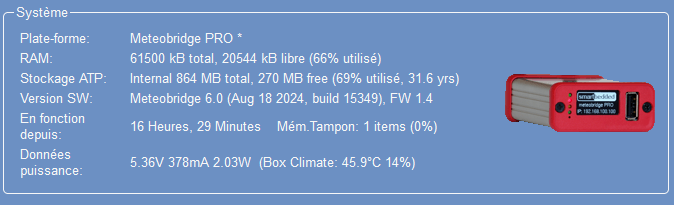

Which SW version are you using? Which platform?
oncletom17
Posts: 25
Joined: Mon Mar 11, 2024 9:38 pm
Re: Problem with rain total. **solved**
Post by oncletom17 »
admin wrote: Thu Oct 03, 2024 4:18 pm Which SW version are you using? Which platform?

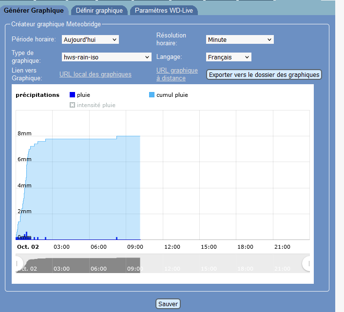

Capture d’écran 2024-10-03 164633.png (32.41 KiB) Viewed 4347 times

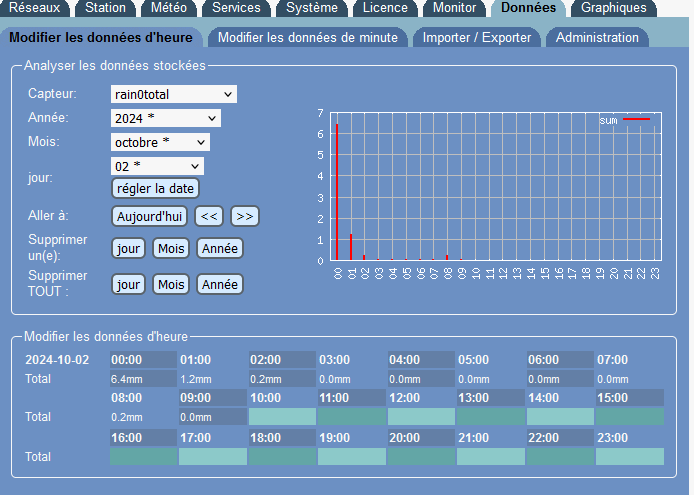

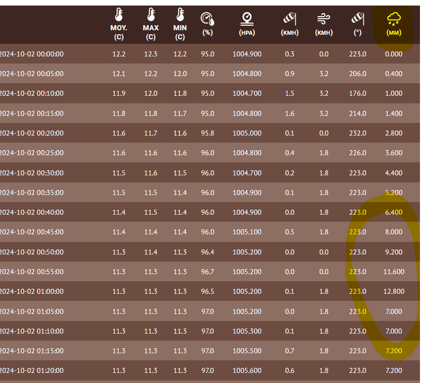

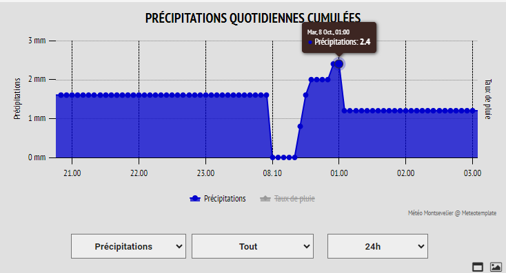

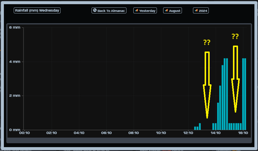

And again today...
Capture d’écran 2024-10-08 065331.png (25.66 KiB) Viewed 4059 times
this case makes me understand the problem: apparently, meteobridge divides by 2 the amount of rain that falls between 00:00 and 01:00 when it's 01:00
Today: 2.4 mm => 1.2 mm
2nd October => 12.8 => 6.4 mm
