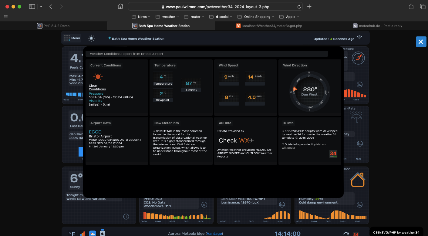

ToTo wrote: Fri Jan 03, 2025 11:17 am Local Airport no longer works or remains without output, I have not yet found out why.

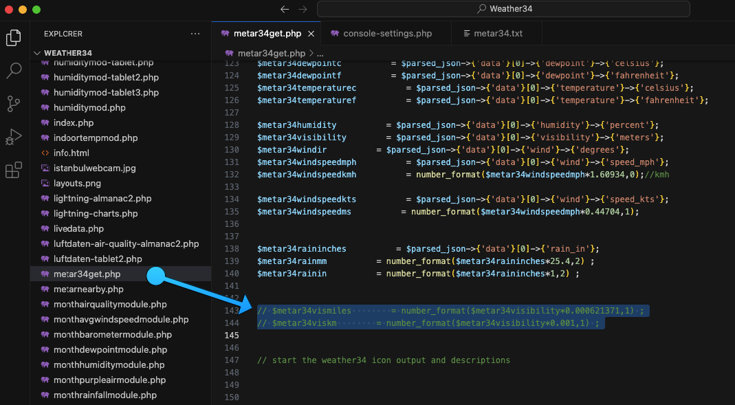

Hello Toto the checkwx API output is short so do this
goto edit file metar34get.php
find the two lines
$metar34vismiles = number_format($metar34visibility*0.000621371,1) ;
$metar34viskm = number_format($metar34visibility*0.001,1) ;
and basically do this put two // at beggining of each line so it ends up like this
// $metar34vismiles = number_format($metar34visibility*0.000621371,1) ;
// $metar34viskm = number_format($metar34visibility*0.001,1) ;
screenshot of code in file
ends up like this :-) edit the file on Paul Wilmans site https://www.paulwilman.com/pw/weather34 ... yout-3.php
i will look into it further to see if its a permanent solution which is quick and remove the visibility string in the display.

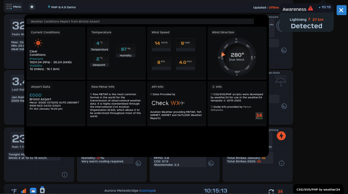

edit: found it the API string change in Visibility from numerical to text , so used the float string in the output and converted the miles to km where required..
see Paul wilmans site should be showing ok now with visibility..brian

The API has "meters_float" for the visibility:
{"results":1,"data":[{"icao":"EGVO","barometer":{"hg":30.21,"hpa":1023.0,"kpa":102.3,"mb":1023.03},"clouds":[{"code":"CLR","text":"Clear skies"}],"dewpoint":{"celsius":-1,"fahrenheit":30},"elevation":{"feet":387.0,"meters":118.0},"flight_category":"VFR","humidity":{"percent":81},"observed":"2025-01-03T16:20:00","station":{"geometry":{"coordinates":[-0.942825,51.2341],"type":"Point"},"location":"Hart, England, United Kingdom","name":"RAF Odiham","type":"Airport"},"temperature":{"celsius":2,"fahrenheit":36},"raw_text":"EGVO 031620Z AUTO 24006KT 9999 NCD 02/M01 Q1023","visibility":{"miles":"Greater than 10","miles_float":10.0,"meters":"Greater than 10,000","meters_float":9999.0},"wind":{"degrees":240,"speed_kph":11,"speed_kts":6,"speed_mph":7,"speed_mps":3}}]}
If the METAR visibility value (9999 in the case of good visibility, beyond 9999m no one in aviation cares) is desired then this line of code (line 41 in metar34get.php) needs to be changed:
from
$metar34visibility        = $parsed_json->{'data'}[0]->{'visibility'}->{'meters'};
to
$metar34visibility        = $parsed_json->{'data'}[0]->{'visibility'}->{'meters_float'};
Which fixes it without commenting out the two lines which I know Brian has suggested as a temporary bypass.
Jason
Posts: 259
Re: The "missing" year 2024 in the Weather 34 template
Thanks worked :wink:
