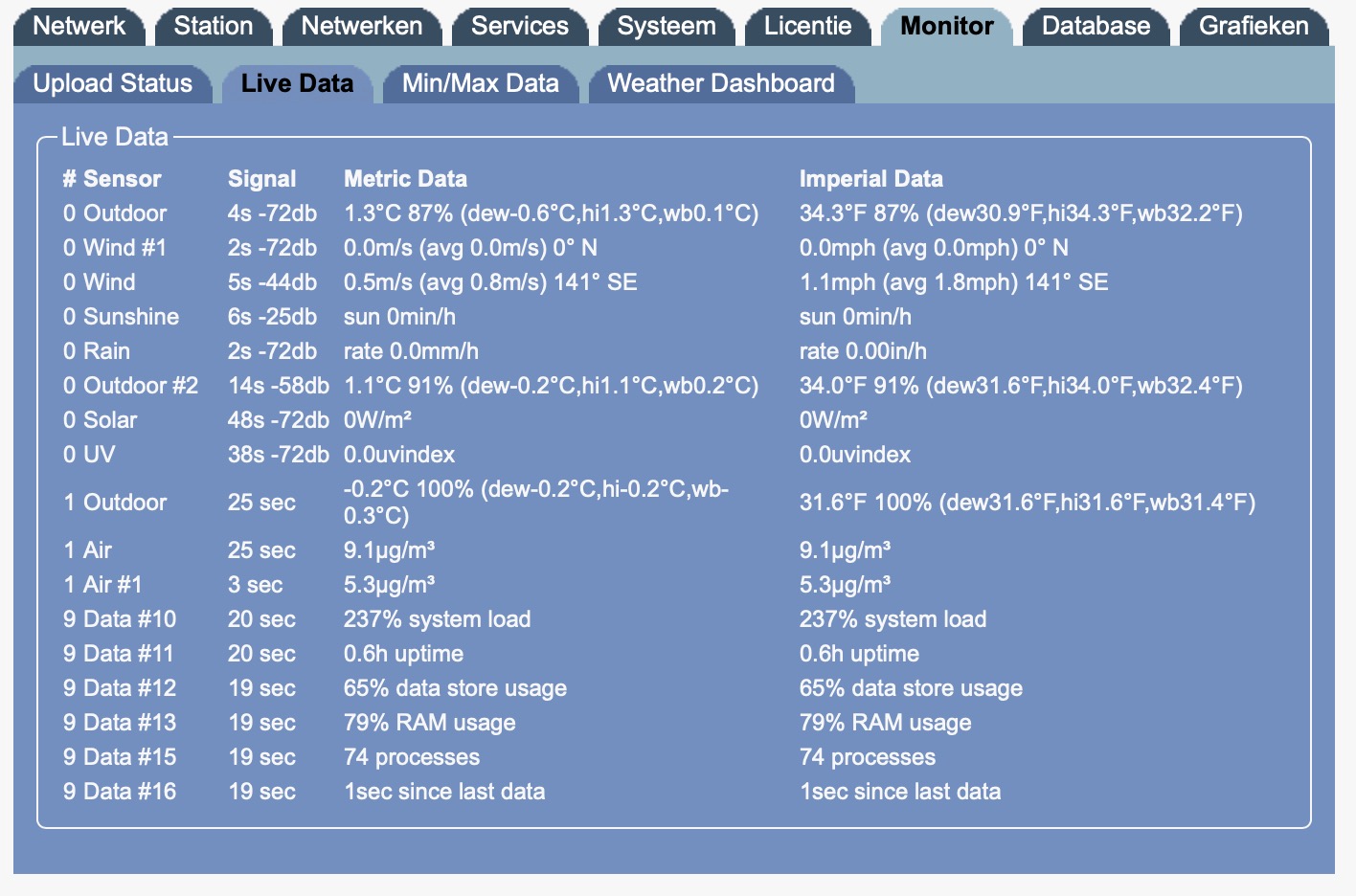

Hi all,
I have a MBpro2 and it seem to have stopped reading / registering / reporting the air pressure. It does not show anywhere. I saw it stopped registering in august. I blamed my website, but when i looked, it seems not to show the airpressuresensor in the MBpro2. Updated to the latest version did not help.
Any ideas how to solve this?
Thx, Gerhard

You have no Indoor live data at all which includes Inside temp/Humidity & Pressure.
You have a very busy lot of multiple additional sensors but not sure why no Indoor?

Mattk wrote: Thu Jan 09, 2025 3:09 am You have no Indoor live data at all which includes Inside temp/Humidity & Pressure.
Yes, I see the sensors direct read from RF (Davis VP2+ and additional Davis sensors. They all show up normally. But the built in sensors of the MBpro2 do not show. I don't use the indoor temp/hum sensor, so i hadn't noticed that was missing also. I do use the Airpressure sensor. These both do not show up.

Indoor sensors are connected via I2C. May by the I2C bus has been stalled somehow? Does a power-cycle fix it?

Thanks for your reply, I tried that, and I also got the latest updates then. It did not help unfortunately.

Can you please provide me a remote login as explained here: viewtopic.php?t=9885
Please send URL and temporary password to "info(at)meteobridge.com".
Re: MBpro2 not showing air pressure
I assume you don't have anything connected to the 4 pin I2C port at the back panel of the Meteobridge? This could block the whole I2C bus.

admin wrote: Fri Jan 10, 2025 10:38 am I assume you don't have anything connected to the 4 pin I2C port at the back panel of the Meteobridge? This could block the whole I2C bus.
No nothing connected to the IC2-bus.
I sent you the login.

Current finding is, that the I2C bus is somehow defective. I will give it a free repair.
