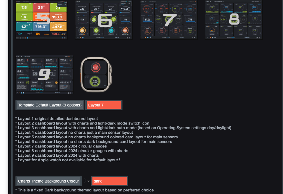

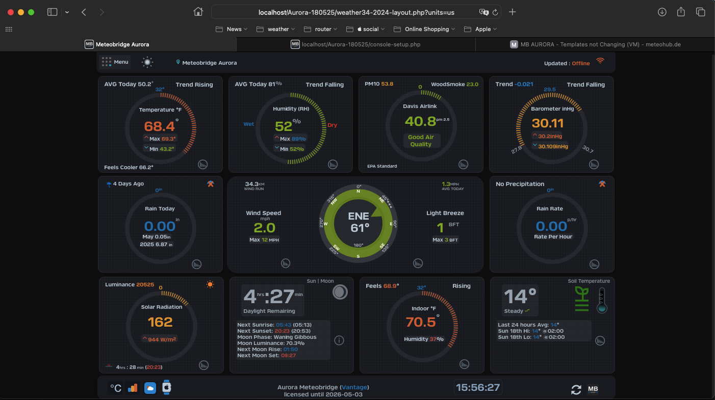

Since the interface is visual, let me post screenshots of how I'm configuring. I have little doubt that I'm doing it incorrectly, so please point out my error.
1. Set Desired Template: #7 with Dark Theme:

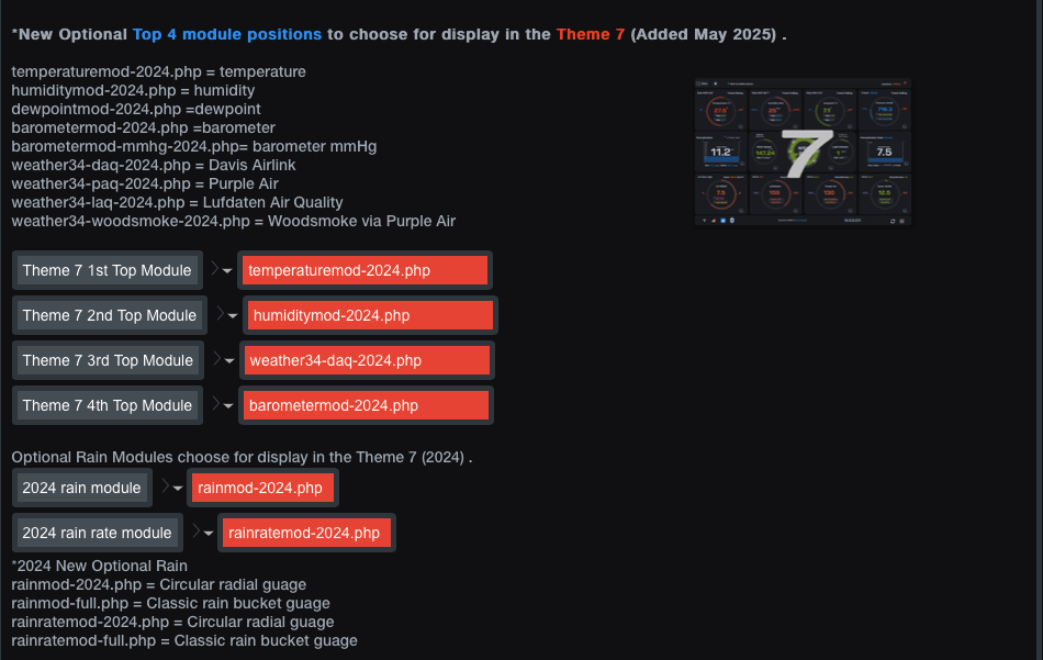

2. Choose Widgets:
3. Choose Optional Template#7 Widgets

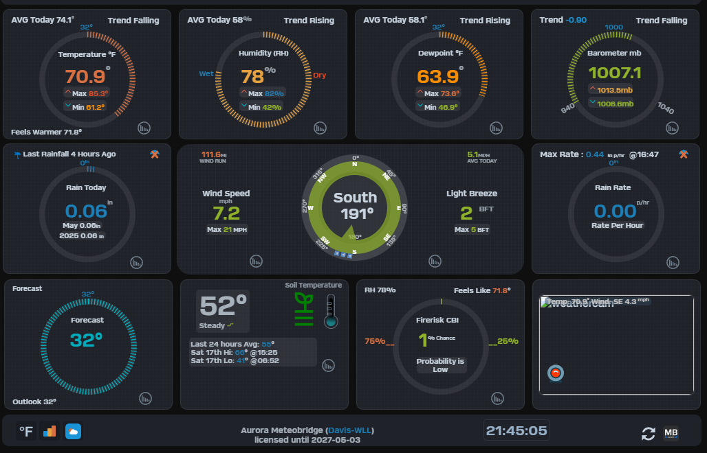

4. SAVE - Refresh - Return to Dashboard
5. Displayed widgets are not the same as selected (For Example, Davis AQI should appear in the top row)
Again, as always, thank you in advance for your assistance.

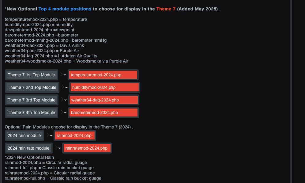

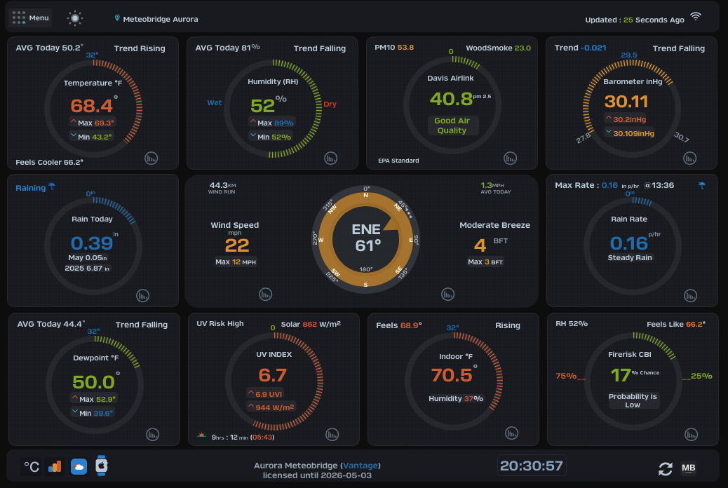

Boris has requested I TAKE a look , the theme unfortunately in the top row is fixed so a long overdue of highlighting this is required however I can if required provide a solution just by a simple modification of the updater file all I need is your preference of where you would like the Davis AirLink module.in the screenshot I've used position 3 top row . don't ask for the middle row as the CSS to accommodate the wind module is critical and best not disrupt that area so you choose any position in top row .
sample SCREENSHOT below
Brian (G7LIJ *NOT QRV)

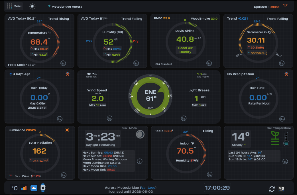

- Posts: 1822
Re: MB AURORA - Templates not Changing (VM)
so it would look like this so no hard coding just use the setup screen.think thats easier way making universal for everyone no point in getting involved in individual modifications because any future simple update would possibly overwrite and keeps it simple
..will forward necessary files to Boris if he ok and understands it then he provide the update via admin panel/screen.
have a nice weekend Brian..

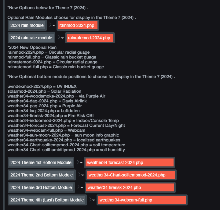

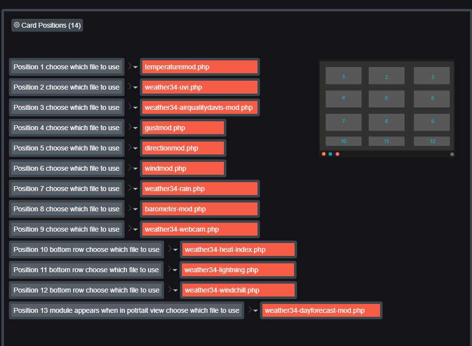

So this is what I put to Boris to approve
added the top 4 modules in theme 7 has options also adding additional options to the bottom 4
see below for clearer picture
hope thats satisfactory
brian
