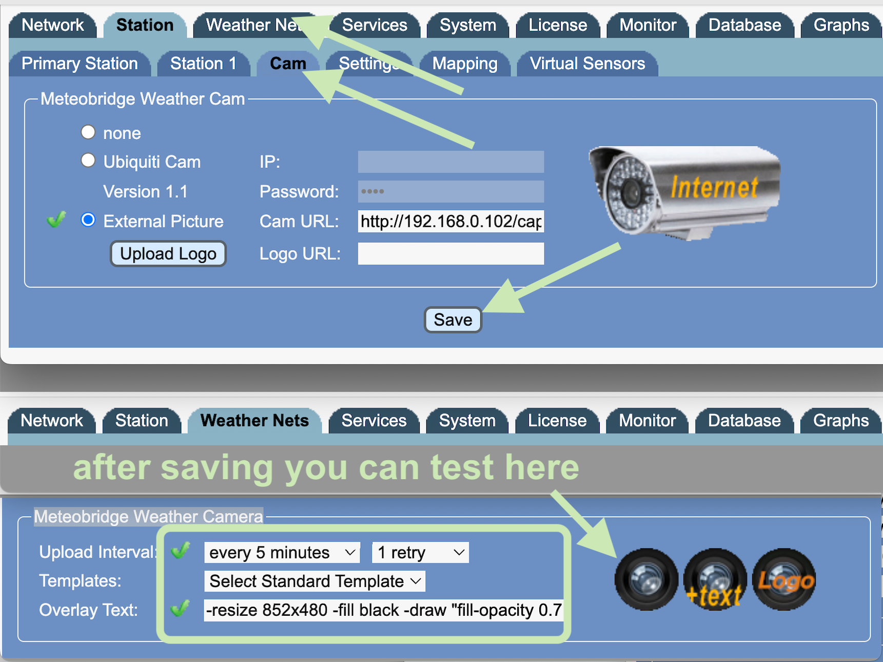

Re: Ecowitt HP10 Camera on Meteobridge
grwkak wrote: Fri May 23, 2025 2:37 pm Looking at adding a webcam to my weather set-up. I am curious whether anyone has an Ecowitt HP10 on their Meteobridge and their experience in set-up and accessing images?
Guy
I use a HP-10 without any problems.
One can locally test the image-capture with the "http://192.168.0.102/capture"
-> replace example 192.168.0.102 with your HP-10 IP-address
Add this link to your Meteobridge -> tab Station -> tab Cam
There will be a green check-mark if your local Meteobridge can access the camera and capture an image
The go to tab "Weather Nets"
-> scroll to "Meteobridge Weather Camera"
--> set to 5 minutes and test with the standard settings.
--> PRESS the Save at the bottom
The you can check the image by clicking 1 of the lens images in the "Meteobridge Weather Camera" settings.
The URL appears in the browser, the it the one to use in your website.
