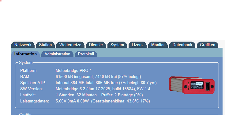

For a few weeks now, my Meteobridge PRO has been restarting itself and irregularly, and now several times a day. This never happened before; I've always had stable performance. The only change: the device is connected via Wi-Fi instead of LAN.
Firmware: Meteobridge 6.2 (Jun 17 2025, build 15584), FW 1.4
What can I do?
Screenshot 2025-06-18 095648.png (43.25 KiB) Viewed 6791 times

Is WiFi Antenna connected correctly? Does it return to stable, when connected via Ethernet?

Had a look at the system details. There is nothing special, no RAM shortage, no massive process load, no WLAN (which can do restarts when antenna not connected correctly), no storage issues. I am a bit clueless. A faulty power connector is my last guess.
