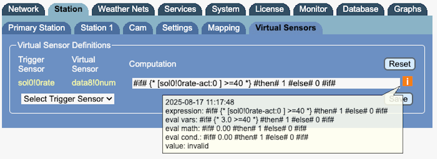

When you look at the execution of the virtual sensor definition (by hoovering over the info symbol) you see, that the resulting value is invalid. That is because the final statement closing the if-then-else construct is "fi" and not "if".
Bildschirmfoto 2025-08-17 um 17.21.34.png (159.39 KiB) Viewed 16483 times
I changed accordingly and now data for "data8!0num" should come in and can be used for graphing.

I still see a #if# instead a #fi# at the end of your if-then.else clause example, which will not work.

Likely similar issue to mine. Syntax issue with the calculation.
Here is copy and paste from my MB:
#if# {* [sol0!0rate-act:0] >=40 *} #then# 1 #else# 0 #fi#
Then you should see it on Min/Max page and be available for sunflag.
When hovering you should see this:
