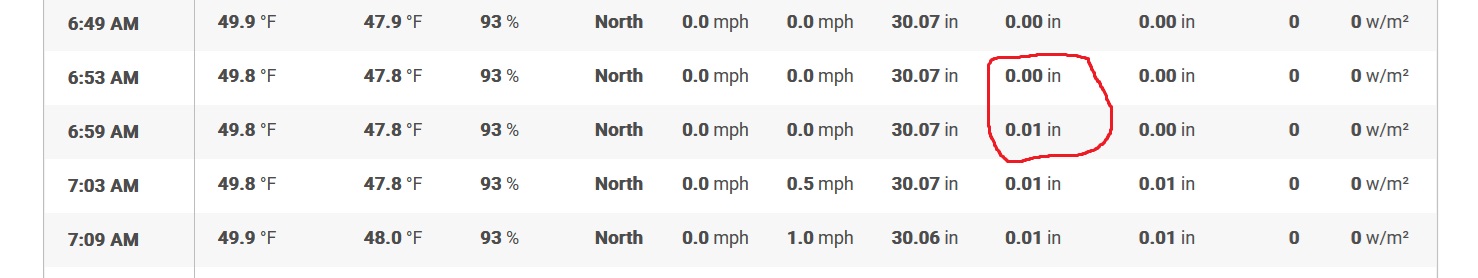

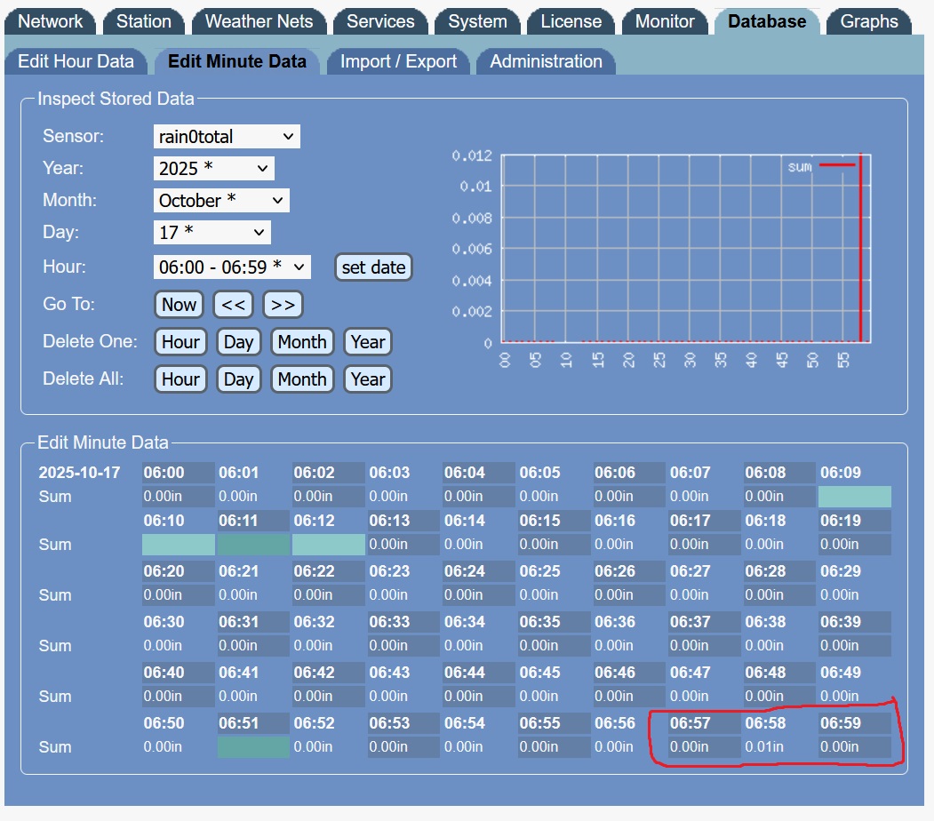

The store per-minute data is now enabled. A little rain (0.01 inches) fell yesterday around 6:58am. All 3 weather servers with the uploaded data show it. Here is a screen scrape from Wunderground:
Looking at the data in the Pro2, the rainfall appears at 6:58 and then disappears at 6:59.
Per chance, is the data only stored to the nearest 0.1 inches?
