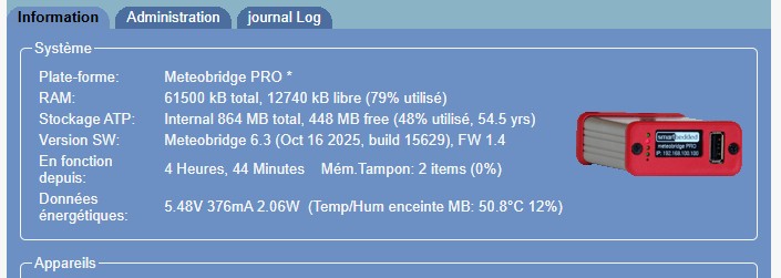

Re: Freeze Meteobridge Pro
Here is the image of the page in question.
- Capture d’écran 2025-10-26 135434.jpg (42.8 KiB) Viewed 1078 times

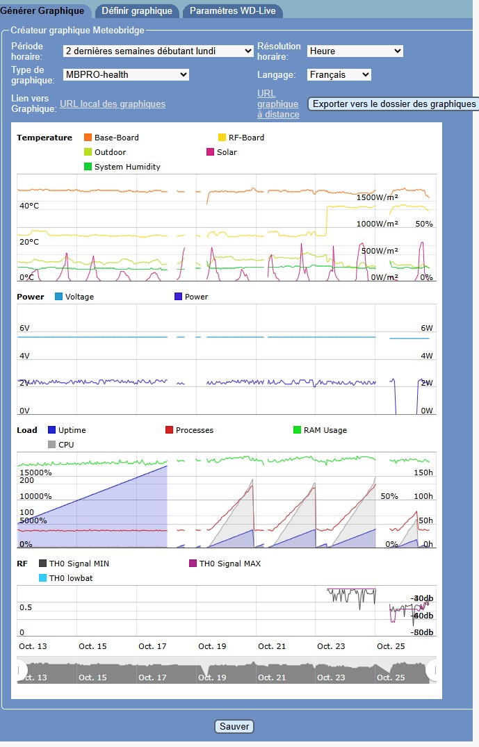

Having a look at the "MB-PRO health" chart might help. Can you please post it here? Chosen time period should cover some stalls.
- Didi
- Junior Boarder
- Posts: 21
- Joined: Thu Dec 28, 2023 12:06 pm
- Location: Lausanne - Switzerland
Is this the painting you're talking about? I took it over two weeks.
- Capture d’écran 2025-10-26 180524.jpg (155.3 KiB) Viewed 1065 times
Process und CPU charts look very suspicious. Number of processes increases until unit crashes.
Does queue size (shown on "System Info" tab) increase over time? Queue can fill up if uploads are tightly scheduled and receiving server processes or Internet are slow. Making heavy use of retries can also make the queue explode.
This increase is indeed strange.
The last two outages were caused by myself because I updated the RF firmware and changed the Meteobridge IP address from DHCP to a fixed address to see if this would have any future impact.
However, I'm including the outage dates below. If the outages sometimes lasted longer than others, it's because I didn't notice them right away (due to absence, for example).
04.10.2025 11:25 04.10.2025 11:55 30 min
10.10.2025 2:55 p.m. 10.10.2025 6:20 p.m. 3 h 25 min
10/18/2025 01:00 10/18/2025 08:25 7:25 a.m.
10/18/2025 3:00 p.m. 10/18/2025 11:45 p.m. 8:45 a.m.
10/19/2025 04:00 10/19/2025 08:25 4 h 25 min
20.10.2025 22:30 20.10.2025 22:45 15 min
21.10.2025 06:55 21.10.2025 09:40 2 h 45 min
23.10.2025 07:55 23.10.2025 09:40 1 h 45 min
And below is the graph for the period.
FYI, I create quite a few graphs that are also present on my site, but I haven't changed anything recently and I haven't had this recurring problem before.
- Capture d’écran 2025-10-26 195729.jpg (221.64 KiB) Viewed 1058 times
Is this the line you're talking about?
Is this the line you're talking about? RAM or Stockage AP ?
RAM: 61500 kB total, 6936 kB libre (88% utilisé)
Stockage ATP: Internal 864 MB total, 439 MB free (49% utilisé, 54.5 yrs)
Looking at the Meteobridge maintenance graphs, I noticed that the processes associated with a particular CPU load have been steadily increasing since October 6, 2025, at 9:00 PM.
I also observed this same phenomenon on July 30, 2025.
Reverting to the previous firmware version (6.3 => 6.2) stabilized the processes. Could this be the explanation for the crash?
- Didi
- Junior Boarder
- Posts: 21
I also forgot to mention that in recent days (with version 6.3) I was getting a lot of Airlink read errors in the log. Since reverting to version 6.2, I haven't had any more errors.
