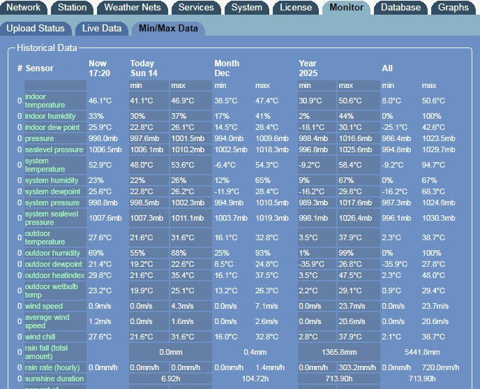

MBPro (Oct 16 2025 Build 15629) uploading to WOW-BE shows constant Rainrate which is not correct.
There was a brief shower 0.4mm @ 03:37am 13/12/2025. Rain gauge is a metric 0.2mm Davis VP2 Spoon, rain resolution setting is 0.2mm
MBPro Min/Max Data tab Rain fall (Total amount) for Today (Sun 14) is 0.0mm Month Dec 0.4mm
Rain rate (hourly) Today all show 0.00, Month Dec (max) 1.4mm/h

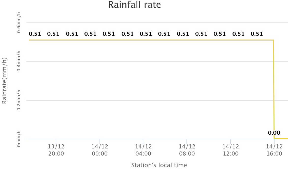

It is currently Sunday Dec 14 @ 09:05 and WOW-BE Rainrate for every record since yesterday shows a rainrate of 0.51mm/h
Two issues I see here is the same ongoing continuous rainrate value (when it's not raining and has not rained today) and the value (0.51mm/h) itself. The connection I see to the 0.51mm/h would be an assumption of being 2 tips of an imperial 0.l" gauge => 0.2" * 0.254 => 0.508mm (0.51mm).

## Update 17:30 14/12/25
@ 16:00 14/12/25 for some unexplained reason Rainrate drops to zero?

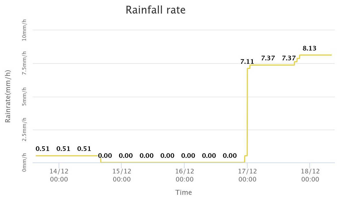

Further thoughts on this one. Can anybody see any logic in the Rain Rate continuation graph when there is no rain, No Rainrate?
For reference data is logging on both MBPro & Davis WLIP from the same ISS. For December total rainfall for both is 8.6mm (18/12), breakdown is
13/12 0.4mm
16/12 7.0mm
17/12 1.2mm (Noting there were four(4) separate and distinct short showers of 0.2mm each between 5 and 8pm on this day (17/12)
18/12 No Rain
8.13mm + 0.51mm => 8.64mm keeping in mind there is some rounding between recorded tips/imperial units with the Davis upload protocol.
Re: WOW-BE Rainrate (Maybe For Boris?)
Rain rate in mm/h is not the cumulated rainfall of last 60 minutes, but a measure for current rain fall intensity computed as a rain fall estimation for the future based on the current intensity of rain.
Looking that way on your data it might not appear that inconsistent anymore?
