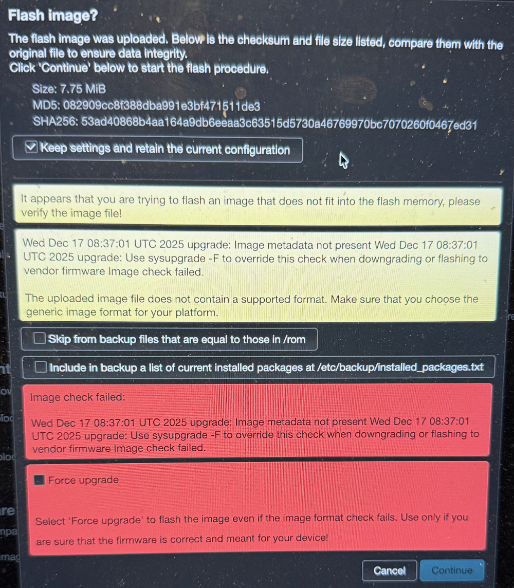

Read the workaround-tip in another thread, about first flash with OpenWRT and then flash the firmware from inside OpenWRT.
Successfully flashed with OpenWRT, logged in and should load the new meteobridge firmware, meteobridge-tl-wr902v3-v1.3.bin.
But when doing the file-checks before the actual flashing, I stopped.
See attachment to thread.
Is it safe to continoue this upgrade... ?
Any other tip to get this unit flashed with Meteobridge.. ?

This device needs to be flashed via a TFTP server as explained in the Meteobridge wiki.
The installed TP-Link firmware does not allow to flash 3rd party firmware via the web GUI.

Re: TP-Link TL-WR902AC version. 4 (EU), flashing firmware
"Doesnt seem to work" is a bit short on information.blizza wrote: Sat Dec 27, 2025 2:52 pm Thx for the reply.
But if you read my post once more, first half of the post is about trying to flash it with tftp as explained in the Wiki(via an tftp server).
But doesnt seem to work.
How did you make sure your TFTP server setup is working?
Did you try with both server IPs?
There is no other way to bring Meteobridge onto this unit.
