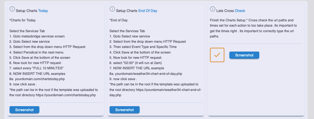

I wonder, if you might be so gracious, and had a few minutes.....if I give you my credentials, could you log into my Control Panel and see if there is an obvious fix? I can see a chart each day, but month and yearly are blank. The data appears to be on the server, but not visible on my webpage.
https://www.morewoodweather.ca/Aurora/index.php
If you are available, please contact d_c_o_l_p_i_t_t_s_at_b_e_l_l_dot_net (remove underscores of course lol)
Re: Aurora 2026 Version Beta !
good morning
you need to run the weather34-chart-end-of-day.php file ive just run it through browser now you have data
https://www.morewoodweather.ca/Aurora/c ... -month.php
see the pdf setup in the download master Weather34_Aurora_MKII_Meteobridge_Setup_Guide.pdf
screenshot of pdf section for end of day...brian

I have all of that set up and have since I started using the W34 on my site. What happened was, I was doing something else, and inadvertantly caused the W34 to stop working. I tried to overlay the newer Master Template (could not find original version from several years ago) and the site "works" now but I cannot see any charts on the interface except current day. All the data seems to be there from back to 2020.....but....... :?: :?: :?:

So my chart problem was simply missing data. The csv files were blank. I thought I had replaced them but obviously not. :oops:
I still see the API errors though.
