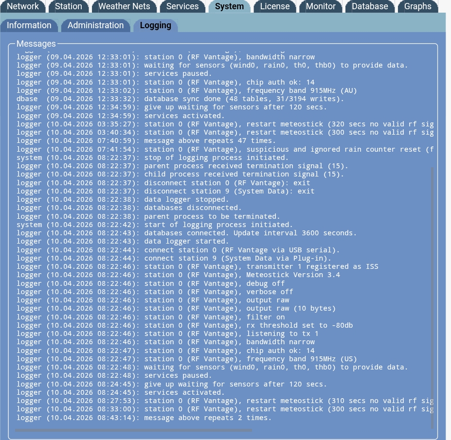

logger (02.03.2026 06:17:28): restart meteostick (350 secs no valid rf signal)
logger (02.03.2026 06:22:30): restart meteostick (300 secs no valid rf signal)
logger (02.03.2026 08:28:16): message above repeats 25 times.

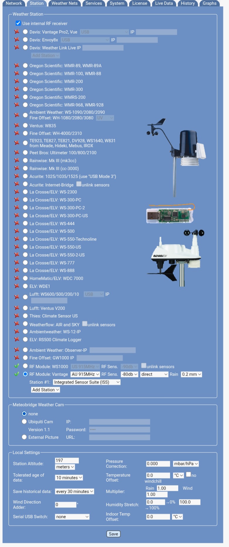

From the stations page....
Green tick but radio box not checked.....RF Module: WS1000 US 915MHz
Green tick and radio box checked......
RF Sens. -90db unlink sensors yes RF Module: Vantage
AU 915MHz RF Sens. -90db direct
Rain 0.2 mm
Station #1: Integrated Sensor Suite (ISS)
Nothing in the Add Station dropdown is selected on this screen.

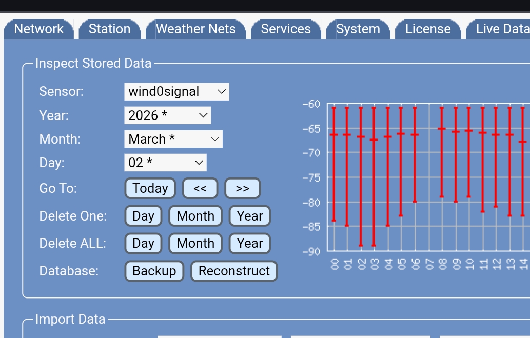

Avg signal is -75. Max -65 and min -95. Drops to 0 between 6am and 7am.
If the sensors dropping at a certain time is that perhaps just the davis running out of battery (i guess its only got so much solar) ? Seems a bit too consistent timing independently of sun or clouds though.

Not sure where the WS1000 model fits in? You have all Davis hardware? The MBPro is a RED, correct?
RF Sens: You could try -80db
Mention of US 915MHz and Au 915MHz confuses me? More info on this one?

Sorry of the confusion. Was just a text copy of the page as couldnt figure out image posting here. US ended up on the wrong line. Fixed now im my original post.
The ws1000 just shows its availabe with a green tick and then a radio button. Not sure if it was relevant but the radio isnt checked and amongst the big list its the only other sensor with a green tick so assumed this might be relevant, sensor is showing 'available' but not enabled.

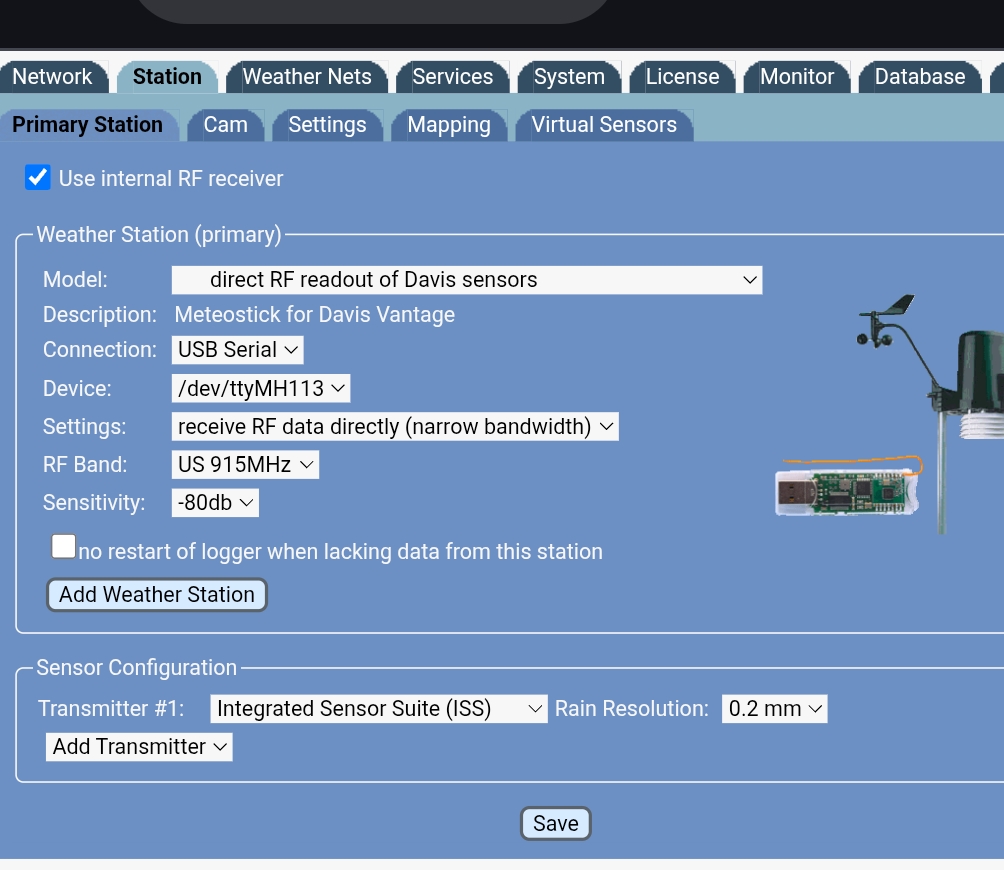

Ok Under the Station/Primary Station>Weather Station)primary) do you have Model: [direct RF readout of Davis sensors]
Connection should be [USB Serial]
Device: [/dev/ttyMH113]
Settings: receiver RF Data directly (narrow bandwidth]
RF Band: [AU 915Hz]
Sensitivity: would set this to -80db
Did you mention if this is a VUE or VP2 ISS?

Vantage Vue or VPS2 ISS won't make any difference, essentially the same thing at the basic level. Can you post a screen shot of your Station>Primary Stations tab?

Here's a scrrenshot.
A couple of interesting charts showing the gap at the same time every day.

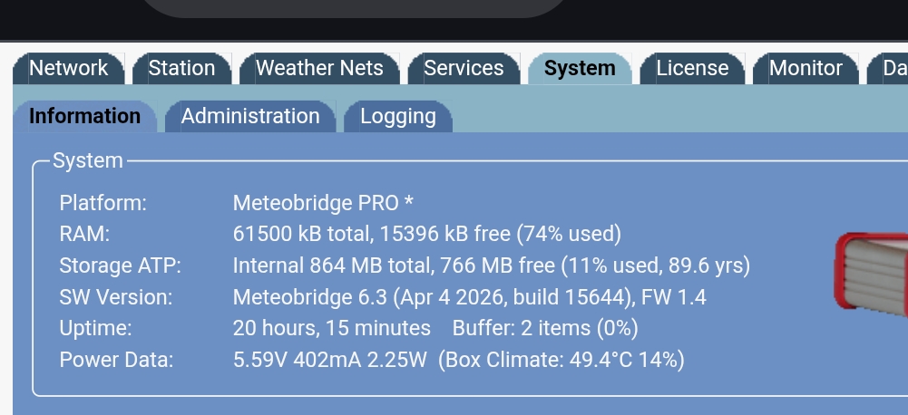

Config appears OK but does appear an old FW version? What is the System info under System>Administration[System]
Might also have to look at RF of the ISS? Is this an AU badge unit that missed becoming AU? Have you tried using US 915MHz? If not give it a go and see what happens?

Tried updating to a newer version. Upon reboot got the an error about unable to download firmware.
Looks like its trying to use 192.168.1.1 for its IP but thats the ip address of the default gateway.
Does the reboot and download latests not just connect via the wifi it was last connected to ? If so why wouldnt it just use the IP its assigned via DHCP and not just default to 192.168.1.1 ? If it does always default to that address for updates on each reboot and software download can i set a different address as the default ?

Setting to US i no longer recieve any data from the station at all.
