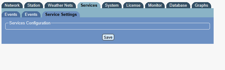

can anybody remind me how to display my service settings ?
I got an "empty"screen when displaying the tab.
service settings
service settings
service settings.png (8.94 KiB) Viewed 1198 times

You see settings there when you have "Events" programmed. Why do you have two "Events" tabs. Something looks borked.
zmarfak
Posts: 11
Joined: Thu Jul 09, 2020 3:23 pm
Re: service settings Meteobridge Nano SD
Post by zmarfak »
I have 13 events.
In the first event tab there are 10 and then 3 others in the second tab.
At the bottom of the first event tab there is a button "next events" that jumps tot the second event tab.

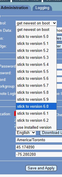

Maybe try different version on a re-boot?

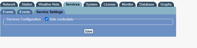

in version Meteobridge 6.1 (Apr 30 2025, build 5059), FW 1.4, I have the screen back, where I can uncheck the
"hide credentials" mark.
service settings 6.1.png (9.49 KiB) Viewed 1145 times
In version 6.2 and current 6.3 it does not show.
I hope the developer will read this thread and come up with a solution.

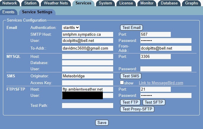

Seems unique to Nano. My RPi on 6.3 is fine. 8)
Bit of an odd ball one? Have never seen that as an option and don't see any issues in several Nano/NanoSD running various 6.3 version from Dec 2025? Do not see this in MBPro or Pro2 either
The only reference I can see to this is on November 5, 2018 where there was an option added which
"allows to hide email/ftp/mysql/twitter/sms credentials within "Services" tab."
