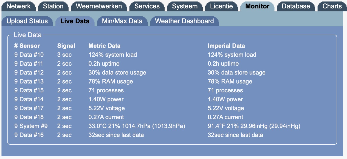

After an update (reboot) of the Meteobridge PRO2 to 6.3 (Mar 25 2026), the values ​​from the Davis weather station are no longer displayed. Neither is the internal temperature. After startup, the orange LED flashes for approx. 10 minutes and then stays lit constantly. The red LED does not light up, nor does it light up for Live Data. This scenario occurs after every startup.
This is also the case with my previous MB (red).
What is going wrong here?
Scherm­afbeelding 2026-03-30 om 10.04.00.jpg (249.28 KiB) Viewed 566 times
Scherm­afbeelding 2026-03-30 om 10.05.03.jpg (173.79 KiB) Viewed 566 times

To confirm any issues with the latest version have you tried downgrading to the last version?
Also is there a Mar 25, 2026 release, as the last version in the release log is February 25, 2026?

I tried a previous release, but this also gives no data, neither on the PRO nor the PRO (red).
Regarding MAR 25 2026 see attachment
