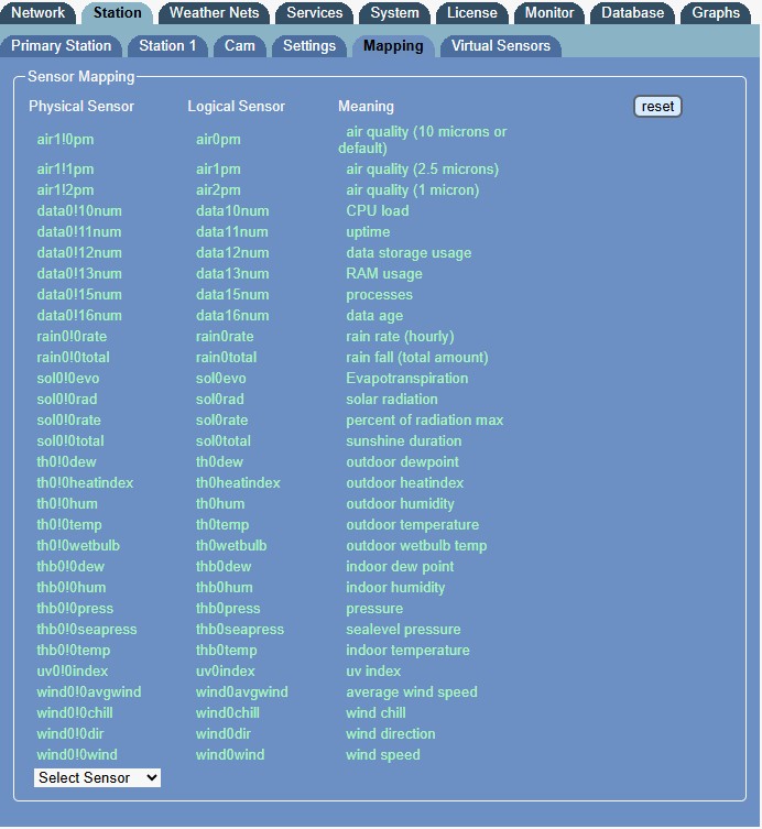

A while ago I had written a used-defined weather station to inport UV & Solar readings. This was setup as Station 2 in the Station panel of the meteobridge admin. These were mapped to uv0index and sol0rad variables.
Meteobridge mappings.jpg (104.91 KiB) Viewed 221 times

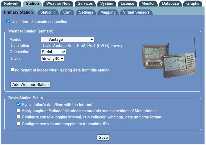

Then I upgraded to a Davis Pro with proper UV and Solar readings and these produced proper uv0!0index and sol0!0rad values and the old mappings were removed and uv0!0index properly maps to uv0index. The old "station 2" was removed.
Meteobridge Station list.jpg (77.76 KiB) Viewed 221 times

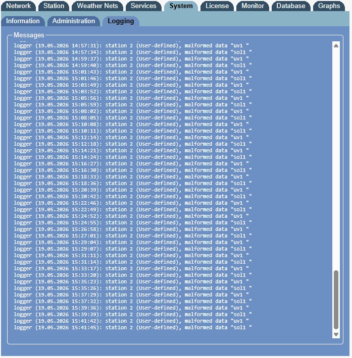

However the meteobridge logging is still showing station 2 doing something, but not working as there's no data available from which to draw readings.
Any clues as to how I really remove this?
