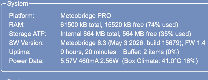

What does the Storage say under the Information tab>System?
Skærmbillede 2026-06-16 kl. 05.52.50.png (74.01 KiB) Viewed 489 times
Yes I think all my data is good :) I do monthly backups, and yesterday when it happened again, I did a backup immediately without any issues.. Also I tried to do an SQL export in minutes resolution, but it failed. Unfortunately I can't give you the errors from the log.

Power Data? V/mA are up a little but not sure if any bearing? My MB Reds are 5.30V 396mA 2.1W & 5.34V 429mA 2.29W so probably nothing of importance?

Mattk wrote: Tue Jun 16, 2026 6:29 am There's nothing visually obvious with the USB stick.
As far as I remember the RPI PSU is 5.5v. I’ve been using the same PSU since the MBP was new.
