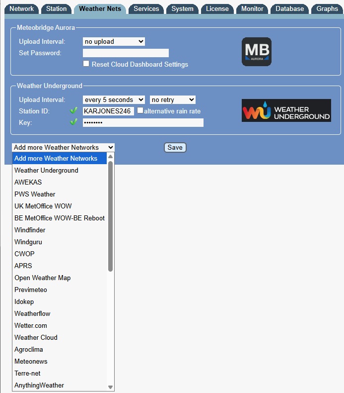

Sorry that doesn't make much sense to me, is this an Event or a Weather Network?
Weather Network (Weather Nets) is a separate tab, under Services Tab there is only Events & Service Settings, both Tabs serve different purposes.
Uploading a script/Template etc can be one under System/Administration [Upload Files] but appear to be referring to Scripts as templates which have different folders, which one does this need to be uploaded to? Not sure there is a "Push" option?
The setting of a URL and interval to 5 minutes to me is referring to adding a Weather Network which are pre-configured. It's all rather vague?
However the realtime.txt file/setup should be straight forward as an event?

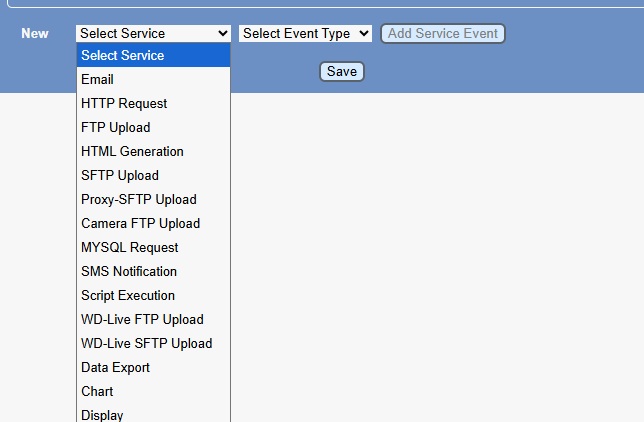

Re: Realtime txt
Ok, realtime.txt is a simple template not a Weather Network
Under Services/Events create a new Event Definition, Select Service to match intended template type (such as FTP etc) noting not all services support all template options, select Event Type and Add Service Event. Fill out the required parameters which will depend on the Event Type, Select File for Upload (template:realtime will be an option) and [Save]
If you copied/renamed the default realtime.txt then the file needs to be in the Template folder.

Re: Realtime txt
What does your Event definition look like? Where are you wanting to upload the output to/
