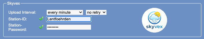

I just release skyvex support as a regular Meteobridge weather network. Please give it a test drive.
