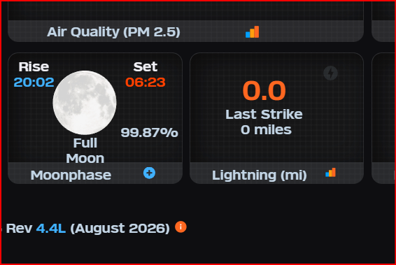

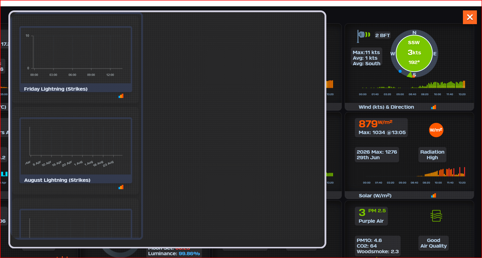

I dont seem to be getting any lightning data showing either for today or in the charts - I have recorded 18 strikes this month on my Tempest
You can see my site here http://ringwoodweather.ddns.net:8000/Weather34/
I am using a WeatherFlow Tempest for measuring lightning which according to the settings should work although my main site above is a Davis Vantage Pro 2 using a Meteobridge Pro
I have attached a screenshot so any ideas would be much appreciated

- Lighning.png (95.27 KiB) Viewed 788 times
- LightningChart.png (666.96 KiB) Viewed 788 times

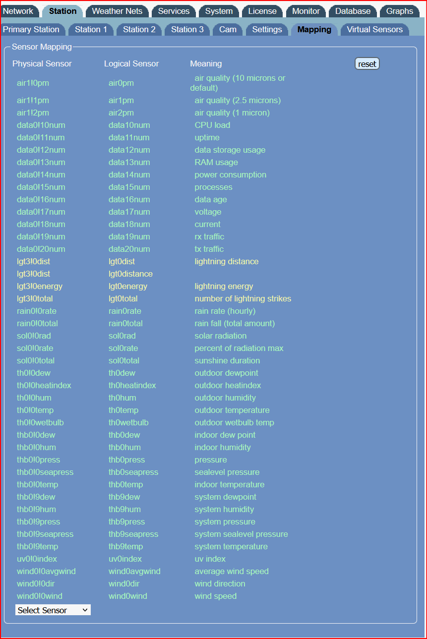

I have attached a screenshot of my settings in Meteobridge
Now it maybe that they are not right and thats the problem but Im not sure either way
Warm Wishes
Graham
- Lightning.png (117.14 KiB) Viewed 762 times

Should I be mapping the physical lightning sensor or the logical - at the moment its using the logical sensor
Warm Wishes
Graham
Warm Wishes
Graham

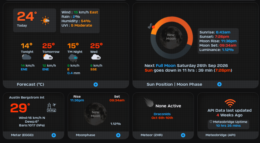

Good morninglorenz1982 wrote: Fri Sep 11, 2026 8:40 am Hi, I wanted to report that the Meteobridge API module isn't updating correctly; it often stalls.
https://meteoborgo.altervista.org/Auror ... 4-2026.php
I have adjust the last two small modules (position 19/20) to update every 10 seconds that might reflect better for that particular module , I don't want to update all bottom modules to ten seconds has that might cause problems(heavy load) for those running of low resource hosting or free hosting services.
