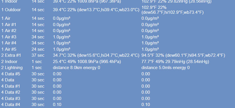

This is my setup (Purpleair is Station 1 and the AQI Plugin is Station 4 - granted not very much dust out at the moment this was taken):
The instantaneous AQI-equivalent becomes available with the first valid PM2.5 sample. EPA NowCast requires sufficient hourly history and normally appears after approximately one to two hours.
