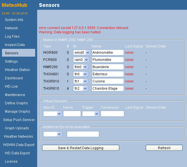

All was working perfectly until last days, for now i get that screen : ( please see attached screen capture )
error connect socket 127.0.0.1:5555 :Connection refused
Warning: Data logging has been halted.

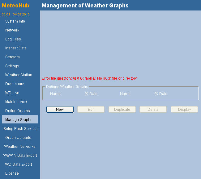

Manage Graph section has also lost all my configuration ( please see attached screen capture )
Error file directory: /data/graphs/: No such file or directory
Manage Graphs section.jpg (46.74 KiB) Viewed 4486 times
sensor section.jpg (80.06 KiB) Viewed 4486 times
