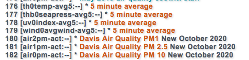

180 [air0pm-act:--] * Davis Air Quality PM1 New september 2020
181 [air1pm-act:--] * Davis Air Quality PM 2.5 New september 2020
182 [air2pm-act:--] * Davis Air Quality PM 10 New september 2020
Thanks for the confirmation. I will change on the upload template by swapping air0pm and air2pm. No need to touch the code on your side for that.

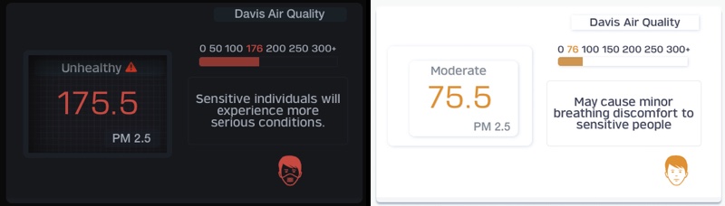

for Davis Air Quality users the module was reworked and simplified in update just now to use only PM 2.5 .. future update will have a dedicated pop up screen like purple air to have the extra data for pm10,temp etc.. expecting mine to arrive this week as customs just cleared it this morning :-) so I can build around something right in front of me without having to guess or assume :-), expect additional charts, almanac data and other things related to this to appear in due course..

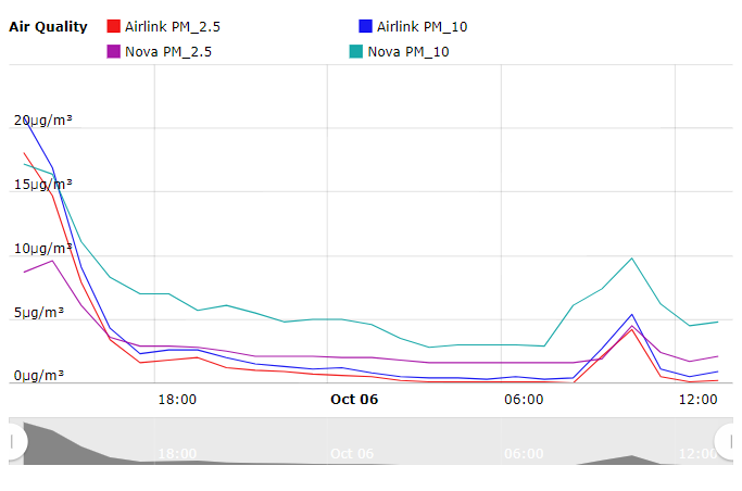

weatherist34 wrote: Tue Oct 06, 2020 11:51 am ... Davis Air Quality ... expecting mine to arrive this week as customs just cleared it this morning :-)
Good news for you. It will be really interesting to see how accurate you think the device is compared to your Nova SDS011. I think my Airlink is not the stunning success I think it should be. I've both sensors in the same room, less than 10cm from each other. The Airlink insists on reading mostly lower and also reading zero particulates (on all three sensors) for periods when I know the air is not "clean".
See the chart below which shows correlation...to an extent.
Jason

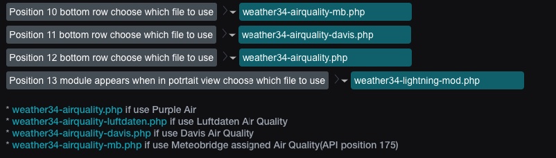

Update 08-10-2020 file
adds additional option for those using meteobridge air quality assigned sensor from different brands.

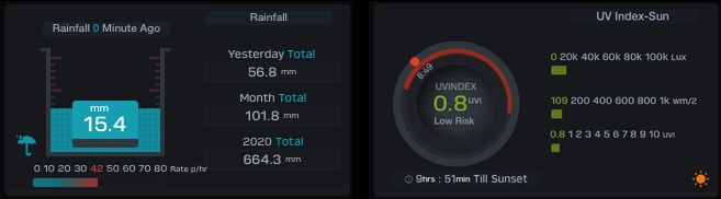

Sorry you missed out on Octoberfest. Just updated to the latest and it looks like there may be a small alignment issue, with the graphic, in the wind modules. I checked it on most all of the browsers and it seems to be pervasive - IOS and Windows.
Take care and have a "Fest" at home.
