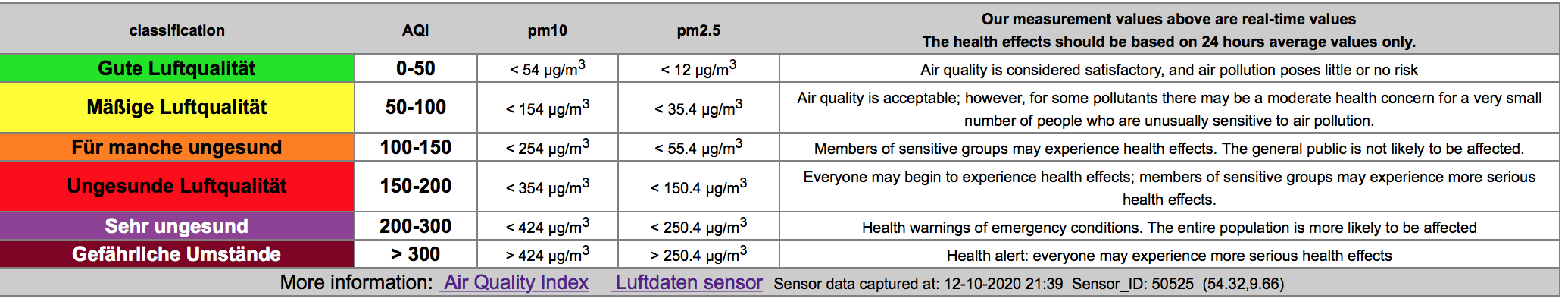

Have found a nice scale of values to determinate the classification of Air quality (Source:Leuven Template):

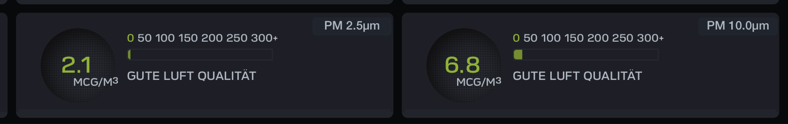

have modified two sensor-value-displays to display only the two raw-sensor values from the Meteobridge-API:

this will avoid the much different interpretations of the AQI-Indexes and it's only based on the raw sensor-values, much more easier to handle for international using in my opinion..
just as a suggestion...

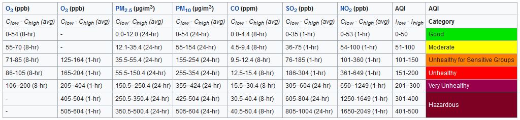

It's a shame that there is not an ISO standard for expressing the Air Quality Index in a uniform fashion worldwide.
For what it's worth, the table below is the EPA (US) standard, and pretty much agrees with the table xray77 posted.

Displaying the actual particle count somewhat solves the problem, but doesn't 'categorize' the health risk.

RaBrand: I strongly agree with you, It is really embarrassing that there is no uniform standard worldwide for the air quality index...
The health-risk is classified by the sensor-values PM 2.5 and PM 10 separately too in both tables i think..
So you can see different "health-colors" for the different sensors...
regards
Mike

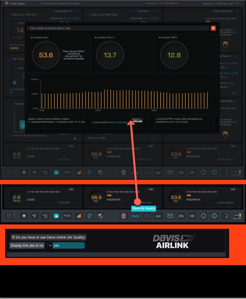

having digested some of the comments on standards it actually gets very complicated so I have simply used the AQI standard which has been used since 2018 in the template . which is basically a 0-300+ as depicted in some of the images above. as for using the pm scientific descriptions that would just confuse anyone who uses the template which provides a view for local community, family etc there are many who do that simply as the template doubles up as an app on mobile devices so best to keep it friendly for everyone.
so Davis Airlink part 1 is done and I will push that update out sometime tomorrow (Thursday) it supports graph data for daily at present I will in due course compile the month data year data scripts for the charts .the chart is the AQI Index based on 10 min intervals , in an ideal specific air quality output an average period would be more suited and that will come when I sit down and adjust the API to output average values like 10 minute averages, 24 hour averages as meteobridge can easily do this .

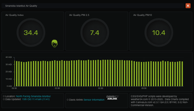

so here is part 1 screenshot note the new option in setup screen this simply is a yes or no which then shows the icon called DAQI which provides link to Davis air quality pop up screen. once again just keeping it simple and manageable.the word descriptions are not translated these require native speakers to translate the language files contain the English sentences.
screenshot of Davis Airlink as above part one the rest will come in stages .
Re: Weather34 TEMPLATE
Looks great. :D My AirLink should arrive on Friday and I will give it a try.
One idea - If the bottom tray becomes too filled with icons, the names on the modules (Davis Air Quality) etc could be linked to the respective popup. May be slightly more obscure for a new user? Just a thought.
good morning chuck
yes thank you thats a perfect idea so I did it like this note the small circle icon within each api module large or small .
all new files and options i pushed to github..

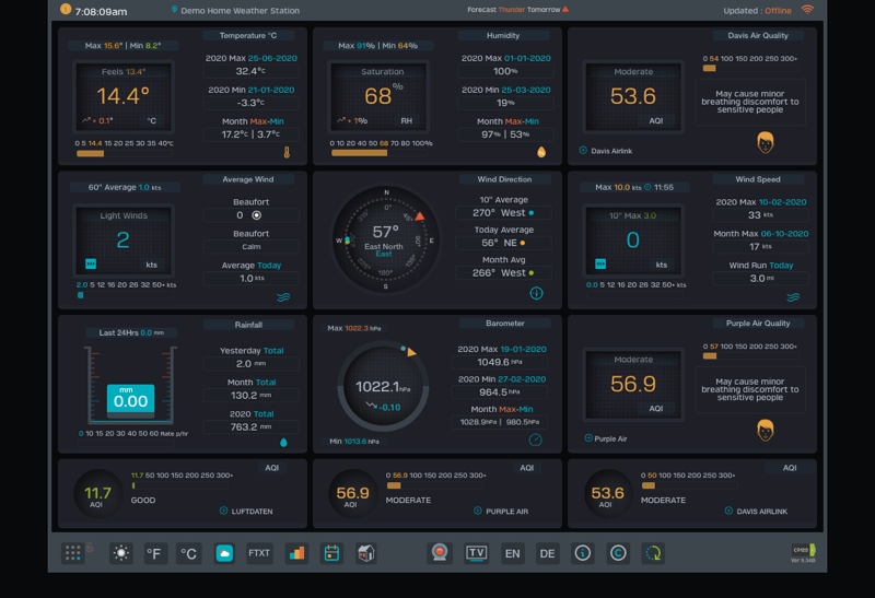

(*Update for 15th October 11:17)
* This update is all about air quality it is phase(1) for new features and additional data
* Air Quality adds new chart view for today with purple air/davis airlink
* Converts all air quality modules to show US Standard Air Quality Index value
* Adds additional US Air Quality Index value along with PM2.5/PM10 for info pop ups
* Adds air quality links with large or small relevant modules
* Adds Davis air quality option to setup screen
* Adds Davis air quality current value for today chart script
* Danish language update ref Bjarne Riis
* Pushed to version 9.34B
treat with caution concerning Air Quality things , expect things to go wrong you might need to take a light hearted view approach or feel amusement Im not perfect but with your constructive help we can make it better :-)

Thank you for this wonderful Update!
Now the air quality data is just as I had imagined, no wishes remain unfulfilled!
Many thanks for your work!

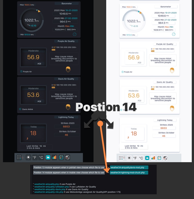

Great. I think having the link in the module may end up being more intuitive. Everything looks nice. :D
One thing I did not think of - it does prohibit getting to Air Quality and Lightning on mobile. :idea:
Take care.
thats easy enough just create an xtra position(14) to use in mobile ..will push to GitHub later..

weatherist34 wrote: Thu Oct 15, 2020 5:48 pm thats easy enough just create an xtra position(14) to use in mobile ..will push to GitHub later..
Ha. Great idea. That will work fine. Actually, the WeatherFlow Lightning (Air) has become so erratic that I have been thinking about giving it up. Sometimes, I have to do multiple reboots of both devices - hub and meteobridge, to get meteobridge to see the strikes. I may try going back to a old version of meteo firmware (4.2) on the one that is running WeatherFlow.
