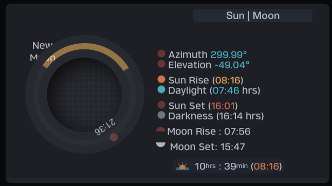

Posts: 259
Re: Weather34 TEMPLATE
I have a problem, with the sun/moon modul:
Can I get a fix for that?
ToTo wrote: Mon Dec 14, 2020 10:41 pm I have a problem, with the sun/moon modul:
good morning if I could replicate I could help , but Im at your site now and I don't see that . any specific browser type ? 9.34 if issue persists its always been there nothing changed in 9.34 since release of the Aurora version.
